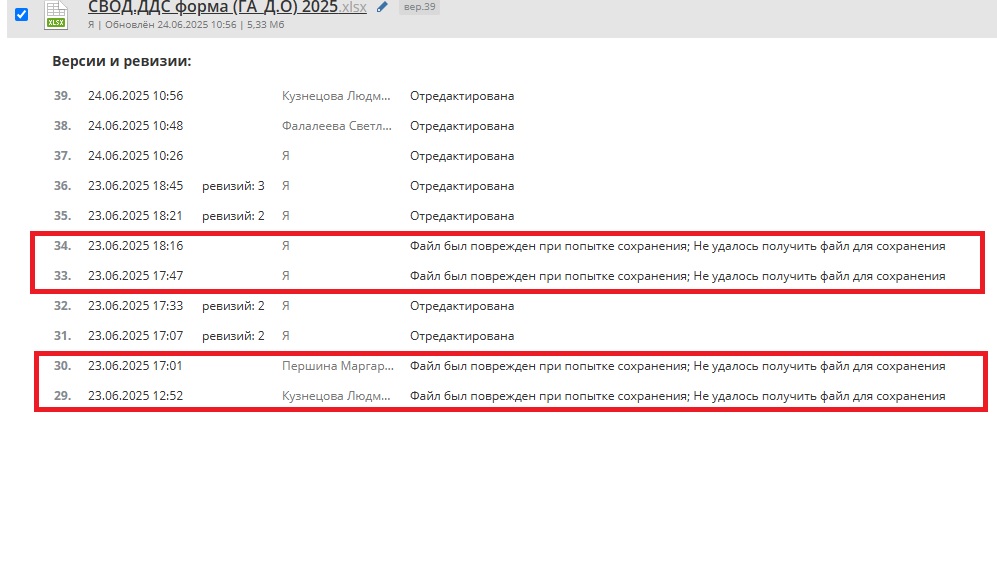

Good morning, unfortunately it’s the same problem, we just moved from Windows to Linux and the save mode sometimes fails, I just noticed that the browser as soon as it reaches 3 GB of RAM immediately drops the connection and the server becomes unavailable at that moment
in the server part the same thing happens when saving 10 GB of RAM reaches 13 and drops, only in new releases it tries to save data twice and gives two errors as in the screenshot above: “The file was damaged while trying to save; Failed to get the file to save”

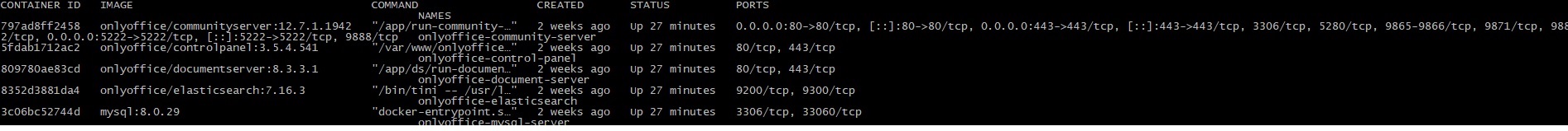

Please point me to the guide that you used for the product installation. If it is all-in-one product such as Workspace\DocSpace, we need the entire logs folder once the issue is reproduced.
Additionally we need versions of of all installed components and docker ps output result from the terminal.
Do I understand the issue right that it is related to file saving process? Does it occur only with the specific file?
In the provided screenshot I see the DMS interface of Workspace\DocSpace(?). - installed ONLYOFFICE Workspace Community
Please point me to the guide that you used for the product installation. - installation guide taken from here https://helpcenter.onlyoffice.com/workspace/installation/workspace-install-docker.aspx
If it is all-in-one product such as Workspace\DocSpace, we need the entire logs folder once the issue is reproduced. - Can I ask you to describe in more detail what you need to provide?
Additionally we need versions of of all installed components and docker ps output result from the terminal. -
Do I understand the issue right that it is related to file saving process? - yes problem with one file
Does it occur only with the specific file? - if it gets buggy and can’t save, then problems can start in other places too

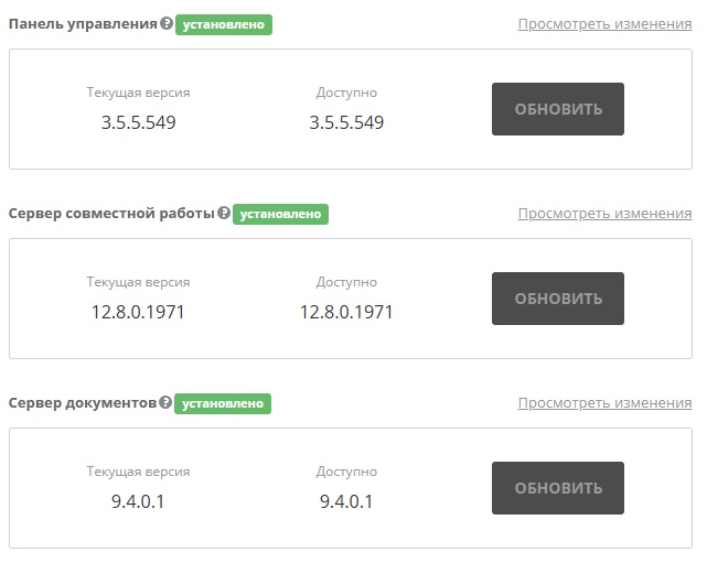

Thank you for the provided data!
First of all, the Document server is outdated, please update it to the latest version: Installing ONLYOFFICE Workspace Community with additional script parameters
NB! Please prepare whole server backup\snapshot before any actions just in case.
Once the installation is up-to-date, please try to reproduce the issue. If it still occurs, we need entire Document server and Community server logs folders. They’re located here:

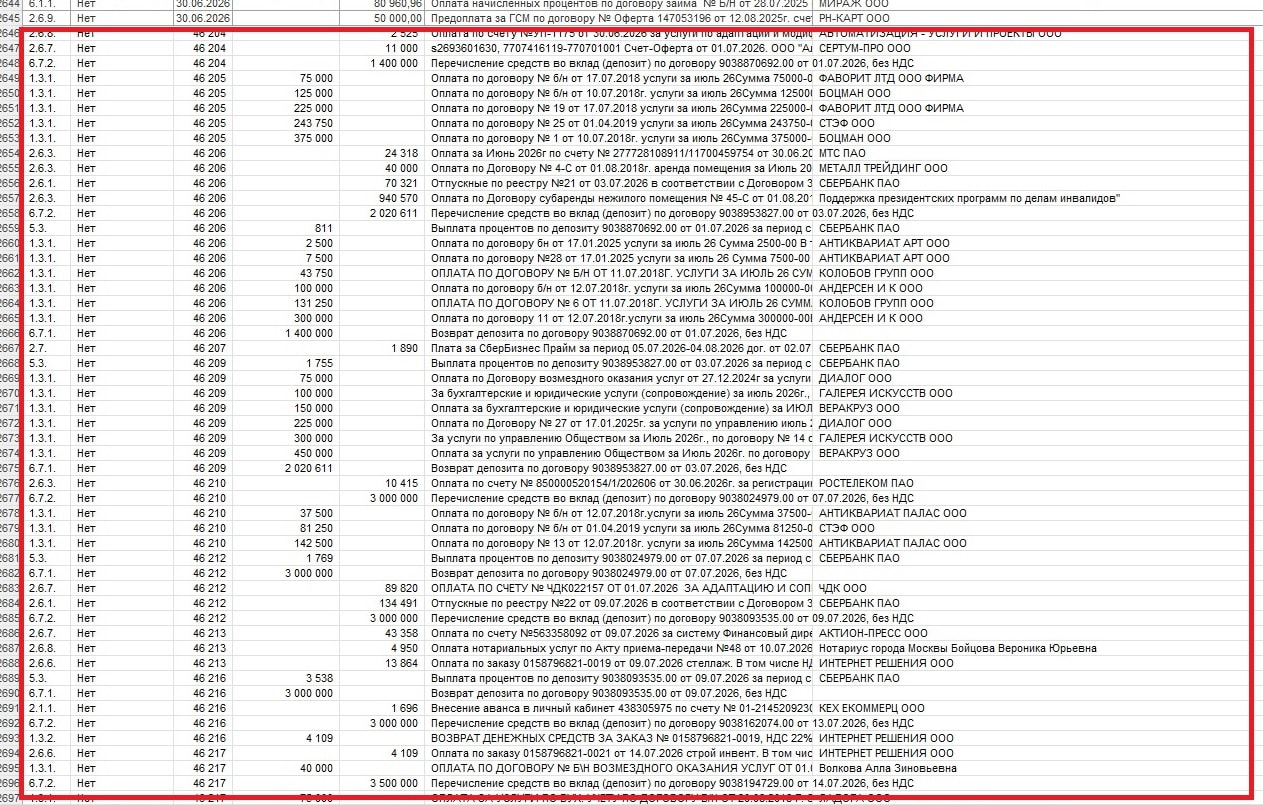

Hello, the saving issue has mostly gone away. It rarely crashes, but it still occurs. Another problem has arisen: the data isn’t clearing properly, turning it into some kind of garbage, as you can see in the screenshot. To clear it, I have to delete the file from the server, open regular Excel, clear it, and then reload it. Also, sometimes it doesn’t calculate the formula, so you can’t click it or press Enter.
The server has been updated to the latest version, this started somewhere 2-3 versions ago with an update.
Hello @Kristofer
Please clarify the exact scenario and what you mean by “garbage.” If you can reproduce the issue step-by-step and record a video, we would appreciate it.
The term ‘garbage’ refers to cleared data (data which is missing from the current session but reappears upon hitting F5). The only workaround to clear this data is to download the file to the desktop, open it via Excel, delete the data, and then re-upload the file back to the server.
