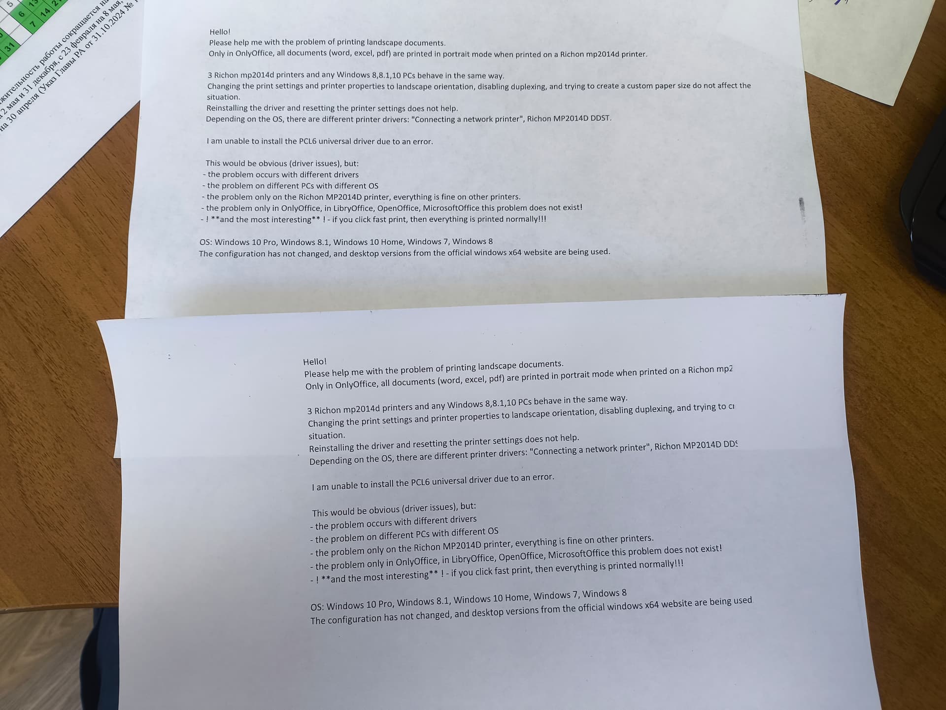

I’ve attached a file. The problem is with any document (docx, xlsx, pdf).
I’d also like to point out that when printing problems, the paper settings in the paper trays on the printer itself are ignored.
In tray 1, there is A4 book paper, and in the additional tray, there is A3 landscape paper.
When printing normally (video 1), the paper is taken from tray 1, which is A4 book paper.
When printing problems (video 2), the paper is taken from the additional tray, which causes a conflict of paper formats.
But even if you change the A3 landscape parameters to A4 portrait, it doesn’t make any difference. The print job still comes with invalid parameters, which causes the printer to complain.
In other words, the problematic printing completely ignores the paper settings specified in the driver and the printer.

And this is how Word files are now printed.
They’re working fine now.
