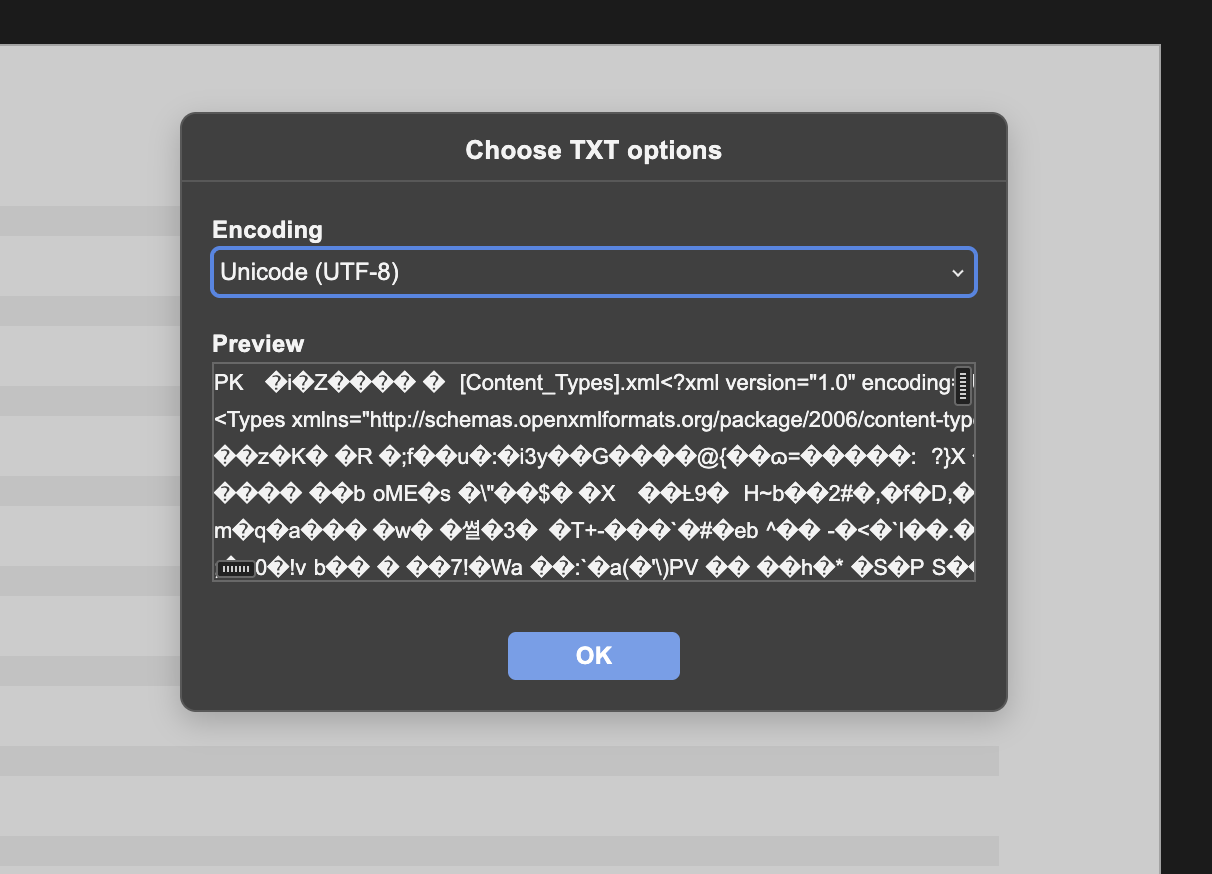

When editing any file (docx, xlsx, pptx) in the Document Server, the file gets corrupted after saving. Showing this image.

The document gets corrupted after saving, and the following error is displayed

As for the issue, please elaborate on how you are saving the file. Status code 89 means that opening parameters are required for TXT. Do I understand correctly that this error appears after the save?

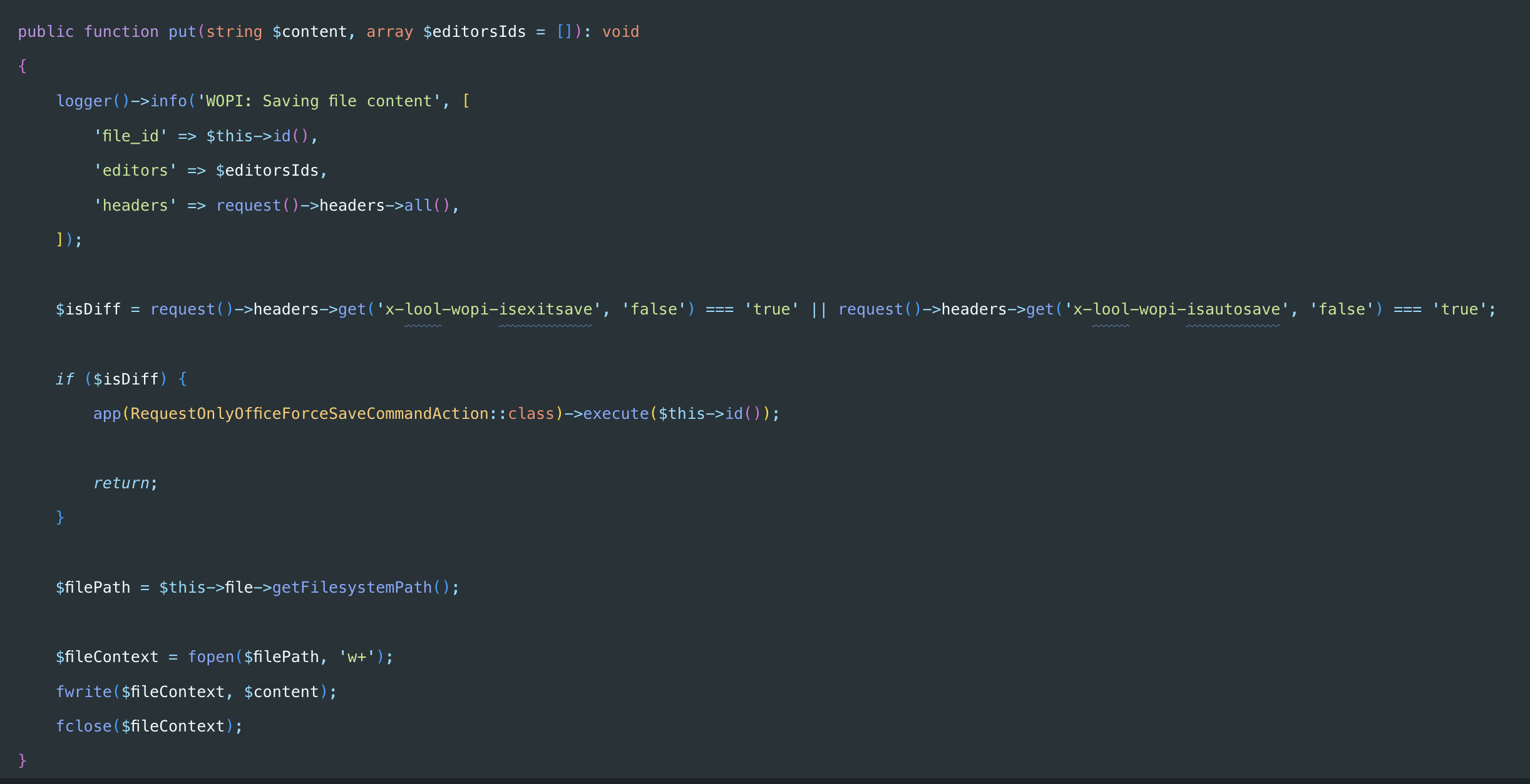

  • I’m using custom wopi host using laravel that implements wopi protocol 100% and passing microsoft testing.
  • I’m using a very simple put function that saves the raw content comes from onlyoffice client to the file
as part of my effort of solving this issue I tried to use Command Service to force save the whole file when exit saving or auto save.
When I open any office file (docx, pptx, xlsx) and make any change and then either:
  • auto save the file and then close it
  • force save the file and then close it
when I tried to open the file again using onlyoffice client it just get corrupted.
