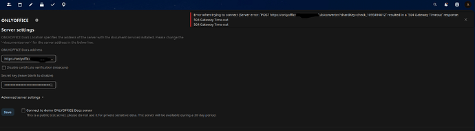

This is what the error itself looks like in the nextcloud_aio interface

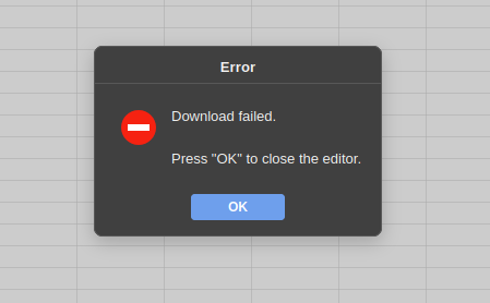

I don’t know if this information can help to understand something, but when I went to the office website itself, tried to open a test document, I waited a very long time for the document to load. Then an error β€œDownload failed” appeared

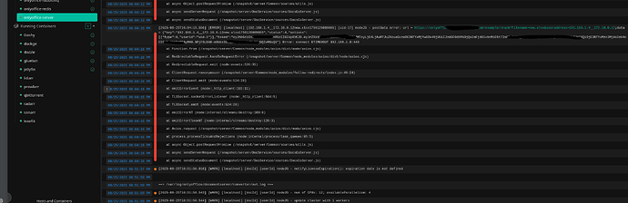

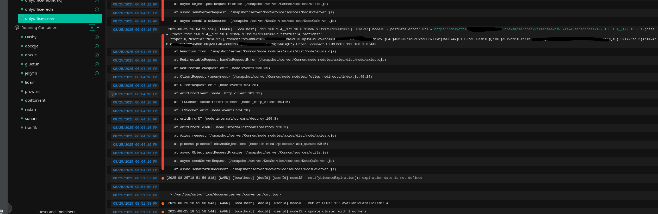

Maybe this log can help to understand why there is a problem with the connection between nextcloud and onlyoffice?
192.168.1.8 is IP where is it located traefik, onlyoffice.
The cloud itself is located on 192.168.1.7

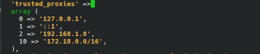

Yes, I have Traefik(192.168.1.8) as a reverse proxy, it is on the same virtual machine as Onlyoffice(192.168.1.8). Nextcloud(192.168.1.7) is on another virtual machine. In the config of Nextcloud, the IP address is specified as a trusted proxy where Onlyoffice and Traefik are.

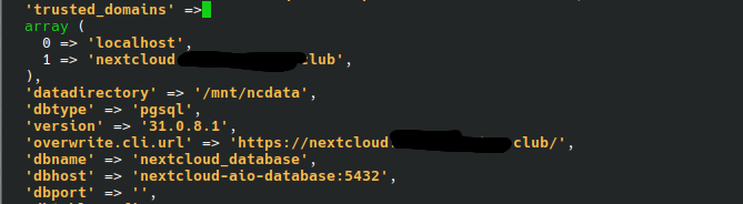

By the way, have you configured trusted_domains in config.php of your Nextcloud?
Yes, I have note about name of cloud.

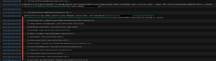

Please reproduce the issue once again and check logs of Document Server right away. What errors do you see? To get even more information, please check browser console, in particular:
  • Console tab for any errors;
  • Network tab for information which request is not completed.

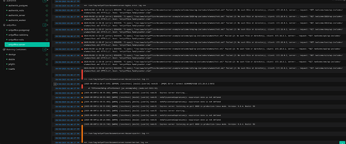

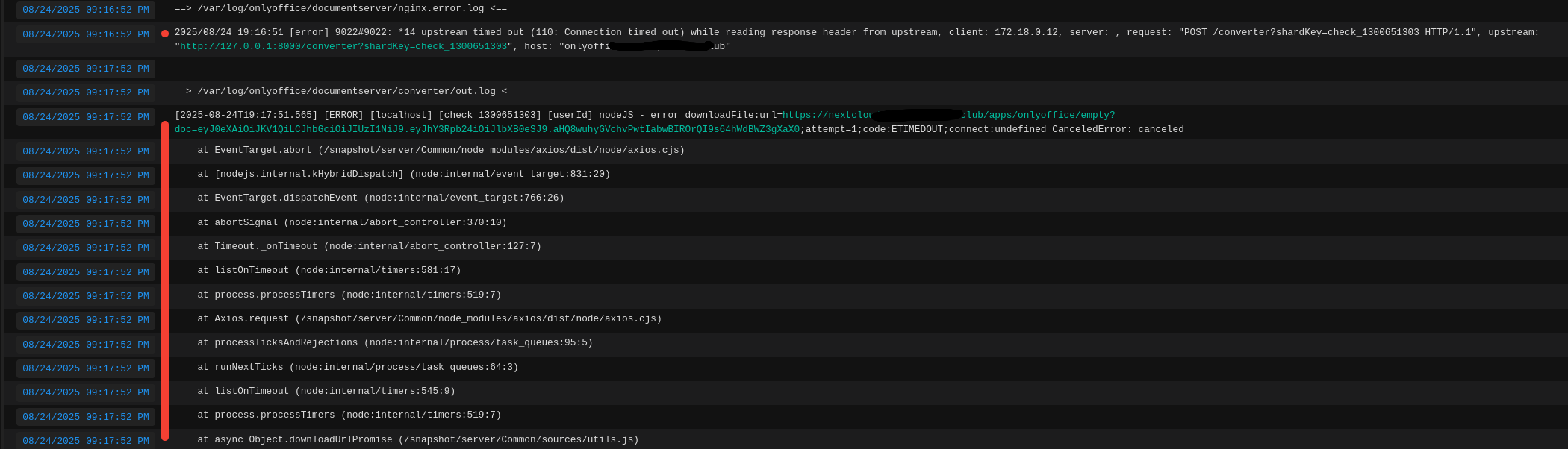

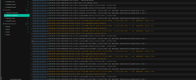

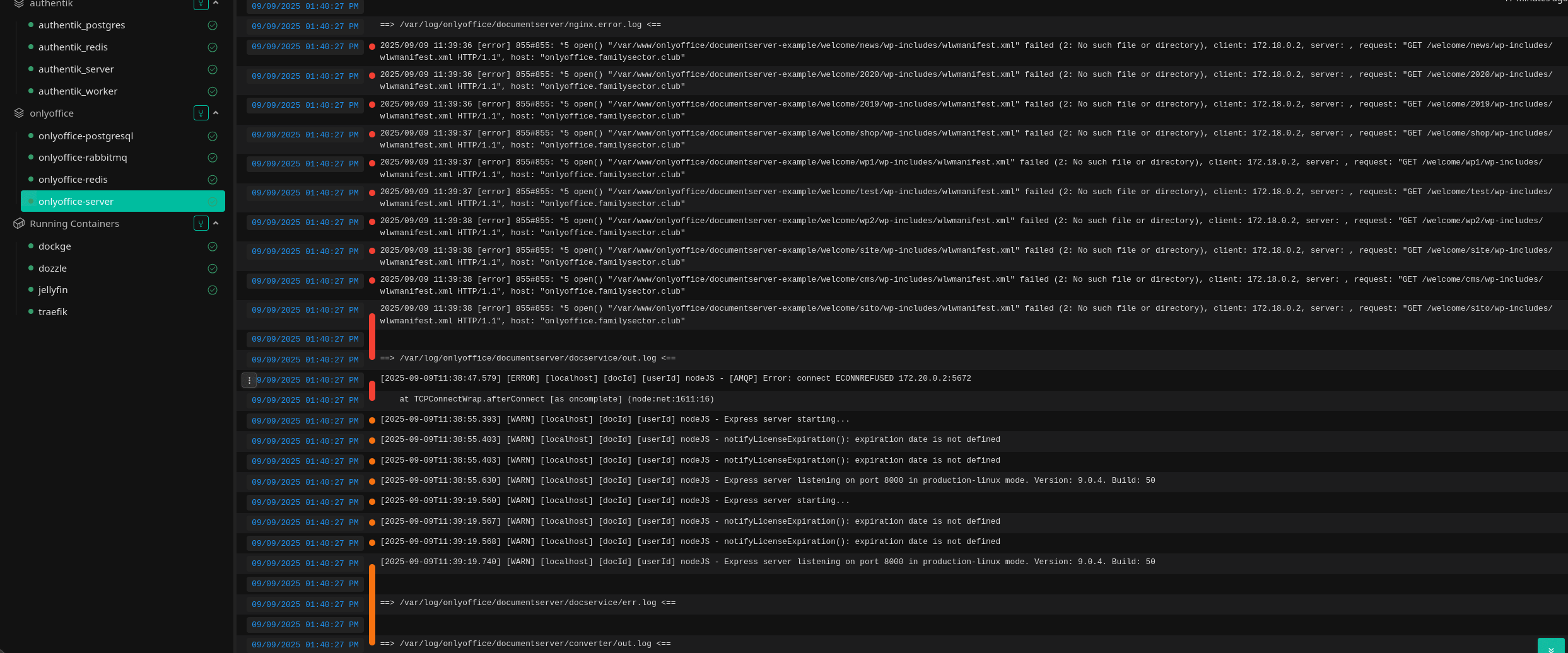

I am attaching files with logs that I was able to obtain both in traefik and when restarting the onlyoffice service itself.
And about return of http://documentserver/healthcheck, I see β€œtrue”.

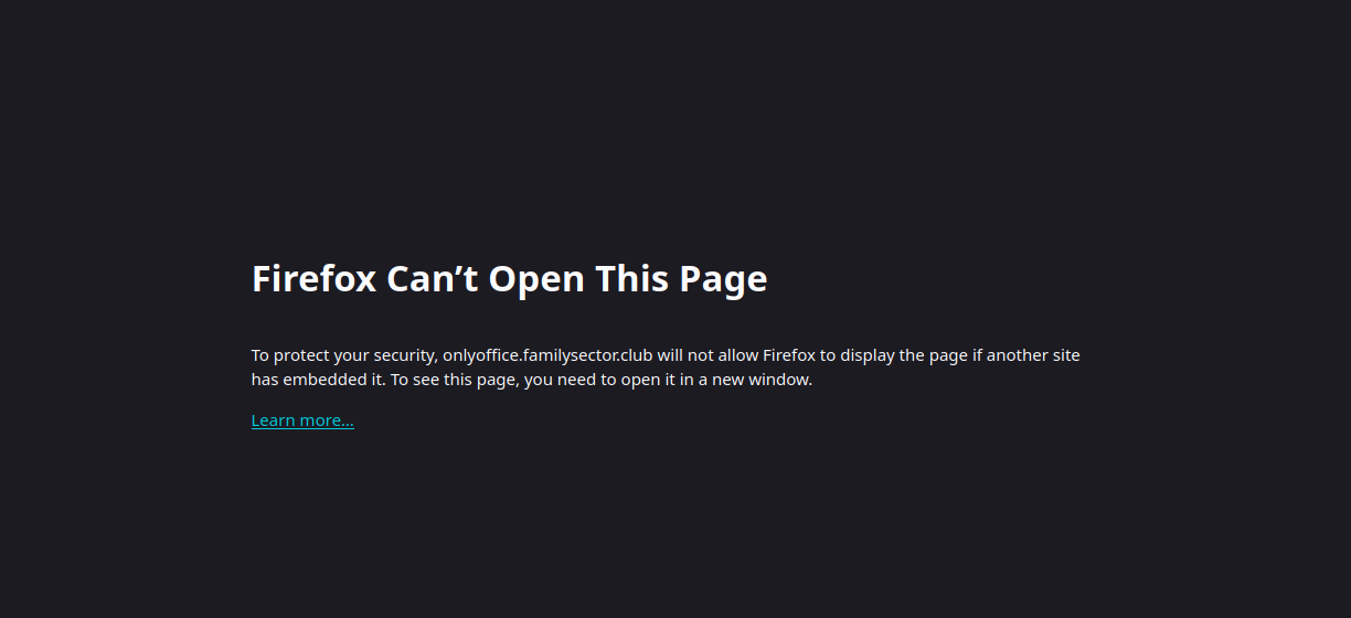

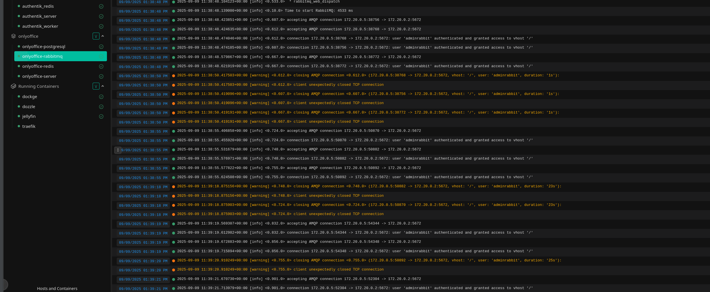

When I try to open test document I see message
I can see that Document Server cannot connect to RabbitMQ. Also, in the example I can see that there is a restriction for X-Frame-Options set to deny.

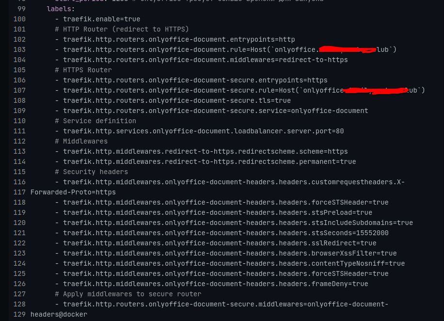

RebbitMQ issue needs to be address by your config. As for the X-Frame-Options, check what value you have for that header:
This is what i have
If you see I have this parameter, but not work.
I see and that is exactly the problem. It set to true, which causes the issue with X-Frame-Options. The description of the parameter explicitly states:
Set frameDeny to true to add the X-Frame-Options header with the value of DENY .
That’s what I saw in browser console.
