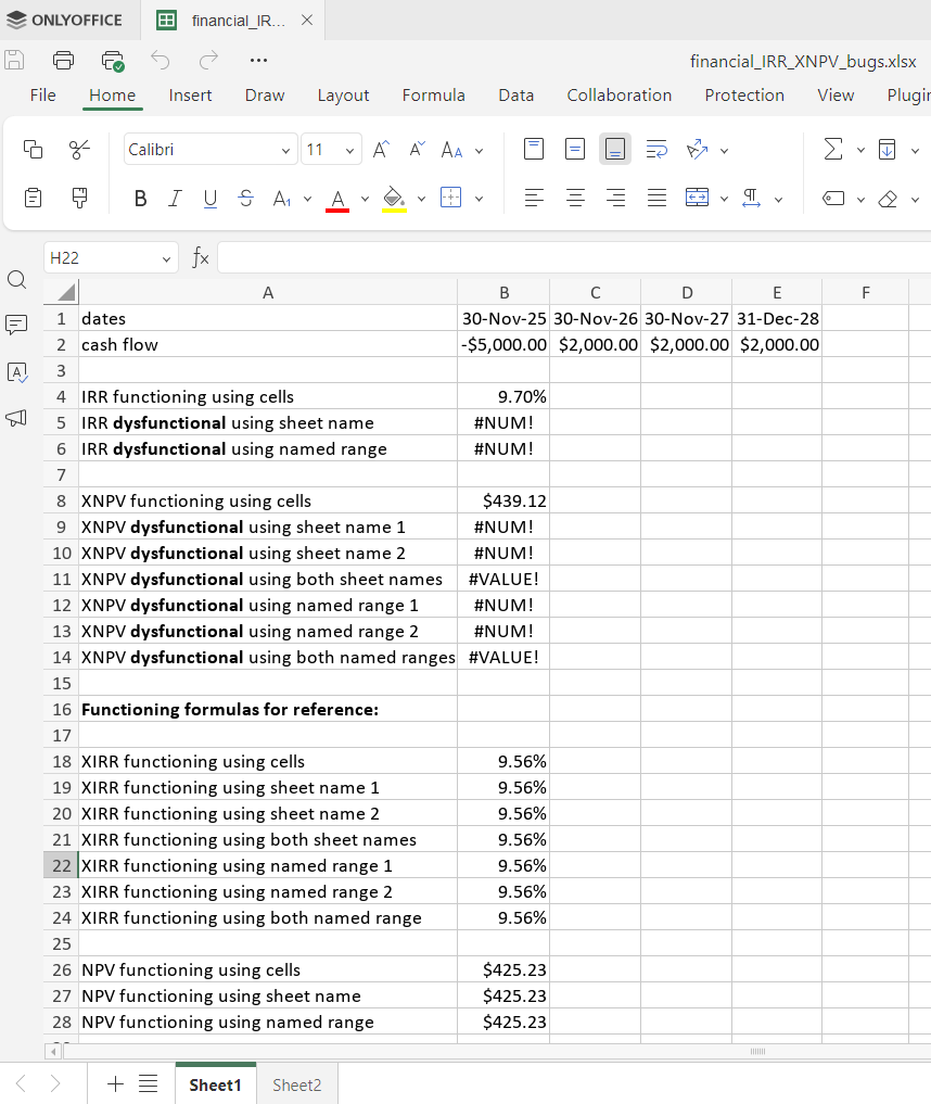

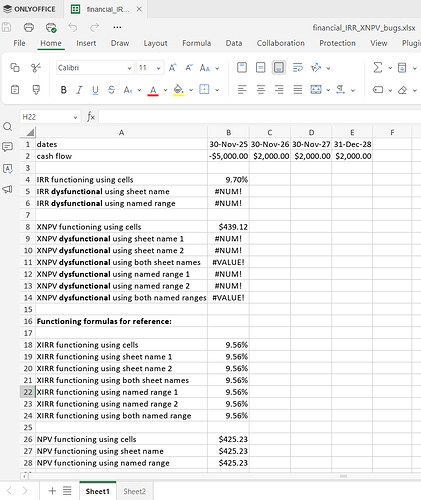

@Alexandre thank you for responding so quickly!
As you’ve advised, I’m attaching a file that includes what I discussed:
financial_IRR_XNPV_bugs.xlsx (10.6 KB)

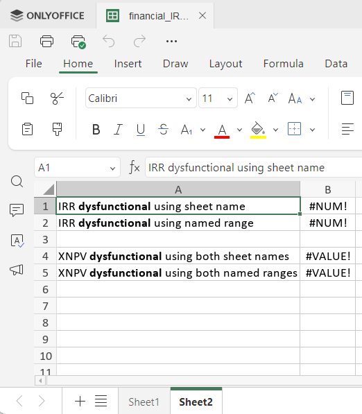

Also, as I mentioned in the original post, I’m just including examples of XIRR and NPV, that work correctly for the sake of reference. And, just also as an example, I created a second sheet to show how the error shows up across sheets.
And for reference, a couple of screenshots of how it looks on my screen (sheet1 and sheet2).
Please do let me know if this is isn’t clear. Thanks!

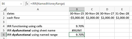

Hi @Alexandre , I have tested the above test xlsx file in the latest v9.2.0 release.
Upon initial opening, the file looks exactly the same as my screenshots showed above.
But for the IRR dysfunctional cells (B5 and B6), if I edit each cell without making any changes (press F2 then just ENTER), the IRR does appear correctly afterwards without the #NUM! error! E.g. if I do this on B6, it looks like:
If I do not save the file, close it, and then re-open it, the #NUM! error will show up again. But if I do the F2+ENTER on the IRR fields, save the file, then re-open it, the IRR will show up fine.
So that’s great!
