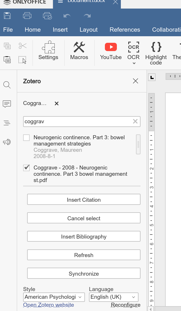

I am appreciating the Zotero plugin, however I am finding it quite buggy.
I initially installed OnlyOffice through the software manager, followed the installation guide but couldn’t get the latest Zotero plugin to work properly. Specifically, it gets stuck at loading whenever I try to insert an in-text citation. I uninstalled the flatpak and tried to use the AppImage file. Initially, I managed to get it to work, however it fell back to the same issue.

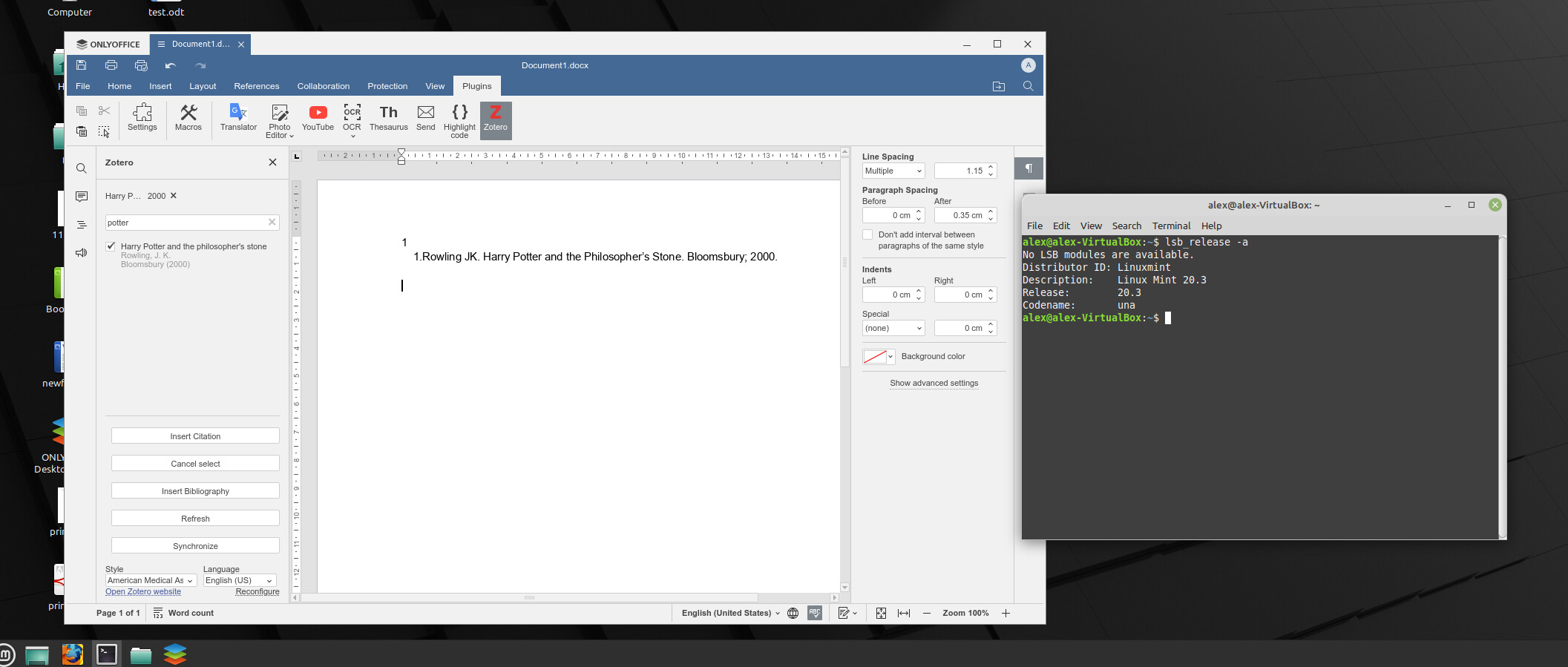

I’ve checked out my Linux Mint test machine and I didn’t find an issue.

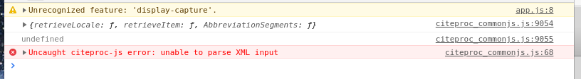

Probably we need additional information. Please try to run Desktop editors in debug mode: Running ONLYOFFICE Desktop Editors with parameters - ONLYOFFICE
This mode allows to open console on F1 button. Please reproduce the issue and send us screenshots from ‘Console’ and ‘Network’ tabs.
For flatpak installation, the debug mode enables with this command: flatpak run org.onlyoffice.desktopeditors --ascdesktop-support-debug-info
Hello Alexandre,
These are the screenshots from the debug:
Thanks again for looking into this.

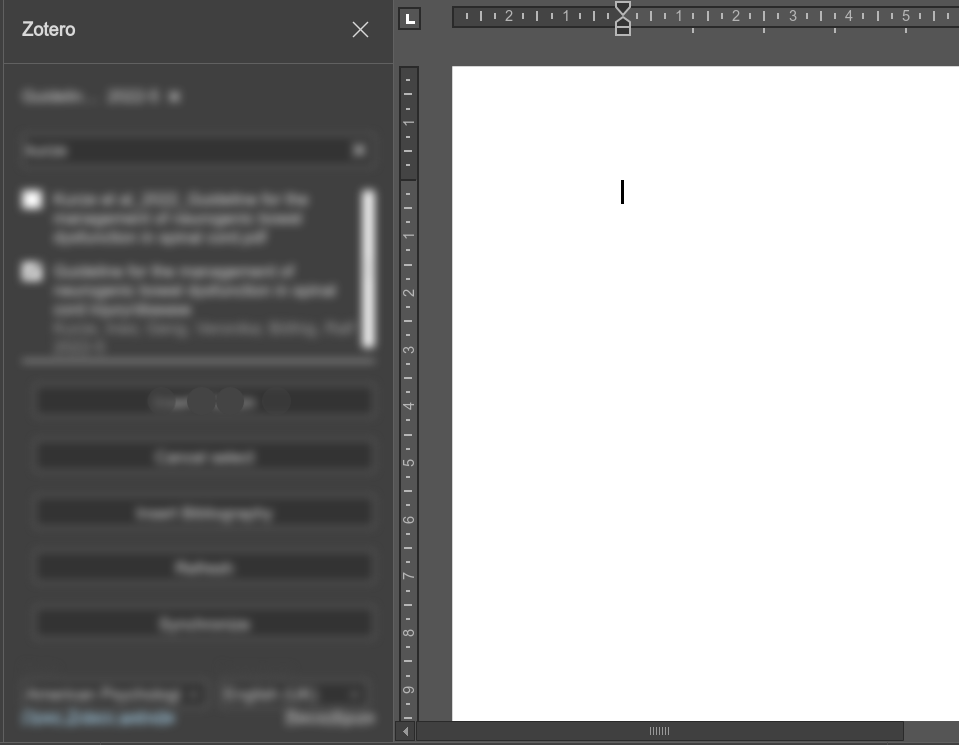

Hello Alexandre,
These are the results after following your instructions:

As far as I understand, you have reproduced the situation with our build of this plugin. I’m afraid we need additional information:
  1. If it’s possible please record entire usage scenario (from the moment you start the Desktop Editor till the issue reproduces).
  2. We need Zotero items list which you’re trying to use (the items which provoke the issue). Additionally, you can create timelimited key from your Zotero Web Library and send it to us. This way we’ll try to reproduce your scenario step-by-step.
  3. Your OS system language, editor language.
