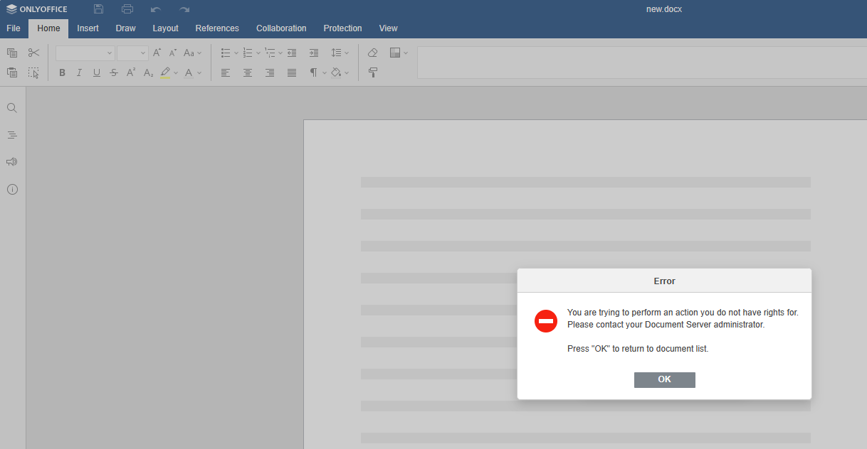

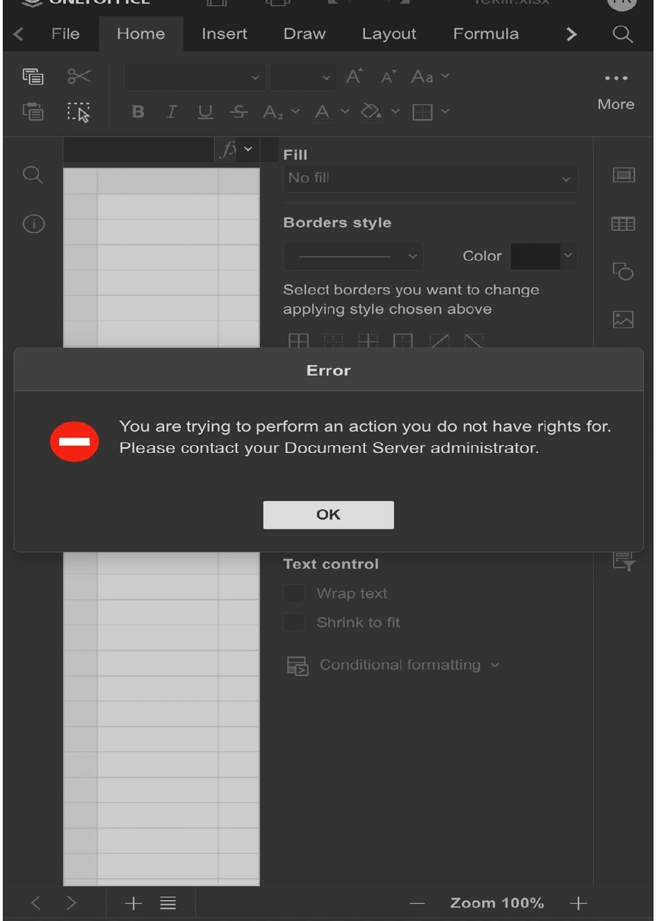

I am having the same problem. Can you help me with this issue?
You are trying perform an action you do not have rights for.Please contact your Document Server administrator.

Additionally, a screenshot of the issue for reference.

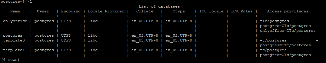

I created a database during the installation. local.json information is available, what should I do?
List of databases
Name | Owner | Encoding | Locale Provider | Collate | Ctype | ICU Locale | ICU Rules | Access privileges
(0 rows)
Eventually database was not created. In this case you need to create one according to the mentioned steps of installation installation guide:
sudo -i -u postgres psql -c "CREATE USER onlyoffice WITH PASSWORD 'onlyoffice';"
sudo -i -u postgres psql -c "CREATE DATABASE onlyoffice OWNER onlyoffice;"
Use these commands to create database, then restart Document Server services with systemctl restart ds-* and check situation again.
ERROR: role “onlyoffice” already exists
ERROR: database “onlyoffice” already exists
As output
List of databases
(0 rows)
