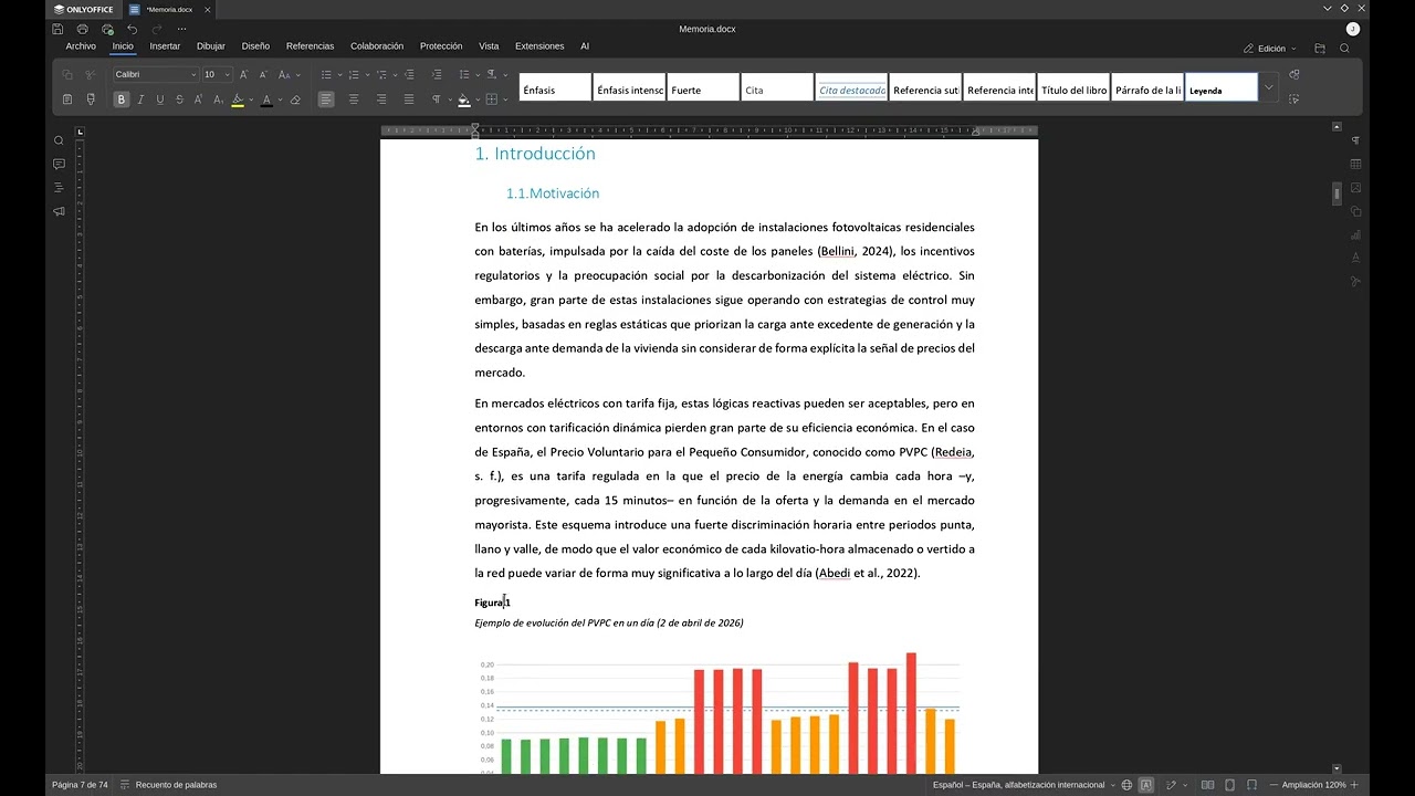

The problem is when I create the tables index and then the illustrations index. As you can check in the following video, clicking on Capítulo 1 (Chapter 1), Figura 1 (Figure 1) and Tabla 1 (Table 1), all of them take me to the same point: Figura 1.

I’ve just checked that if I hover Capítulo 1, Figura 1 and Tabla 1 on each index, all of them are using the same tag: #_Toc1.

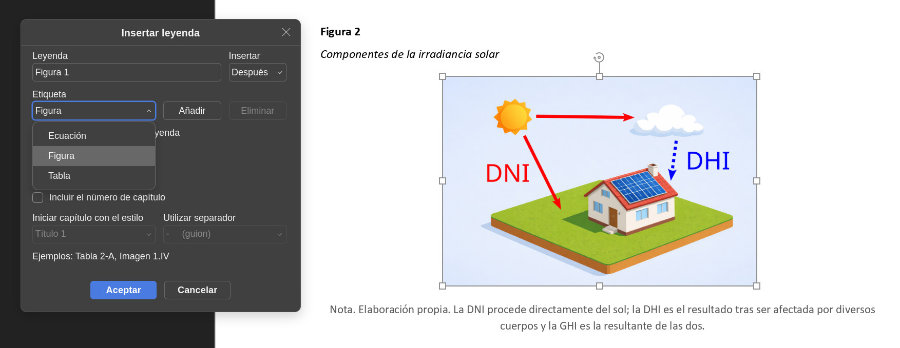

This is the way I create the legend for each illustration/table, changing the type of them:
