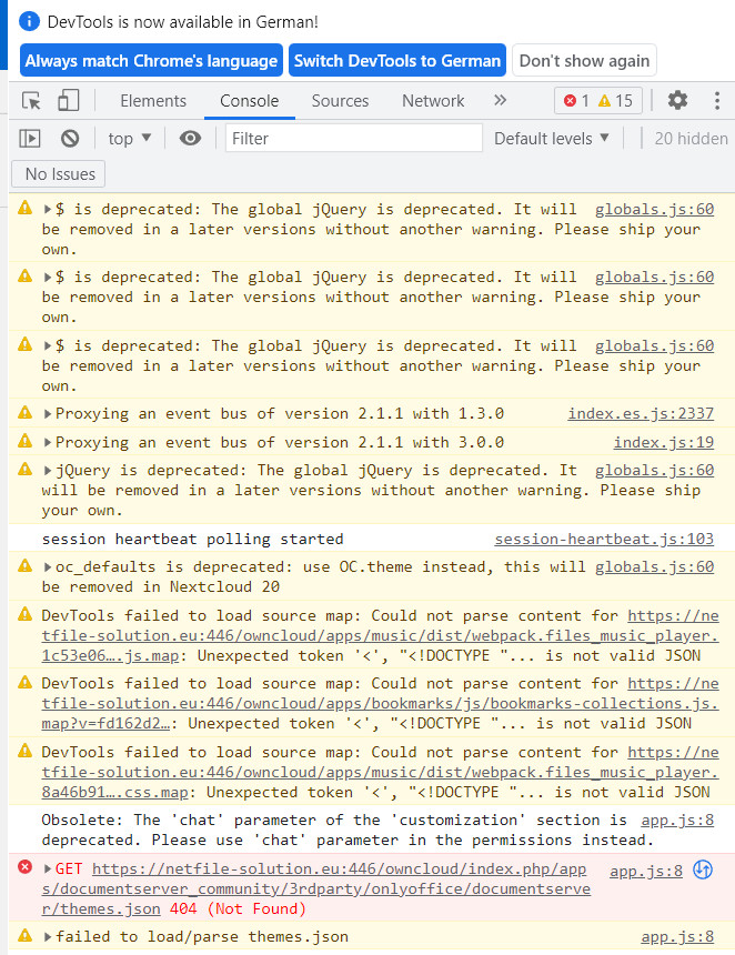

- screenshots of browser’s console network and console tabs.
To do these screenshots please follow this scenario:
- open any document in the editor to reproduce the issue;
- open browser’s console (F12 in Chrome/Firefox/Edge);
- reload the page;
- make screenshots of network and console tabs of browser’s console.

Thanks for the help. I tried to collect the information.
version of Document Server: 0.1.13
type of proxy (if used); no Proxy
information about any modifications made to Document Server’s source code (if made);
screenshots of browser’s console network and console tabs: No changes

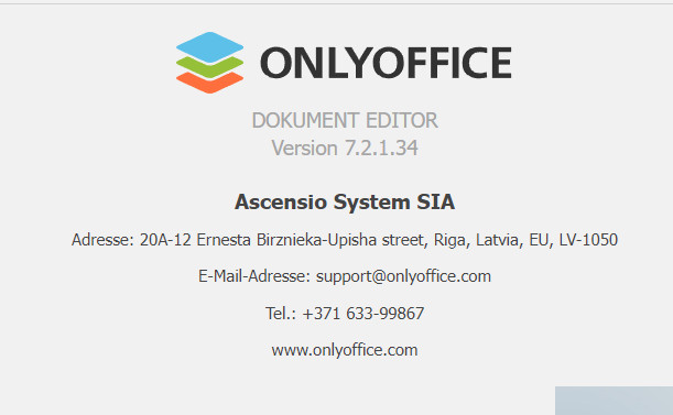

Please double check the version of Document Server.
To see the version you can open any document and on the left toolbar of the editor click “About”:

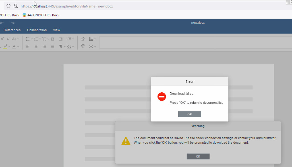

I have now installed and configured the Documente server under Windwos, according to their instructions above. In the basics of configuration, as you have described, everything runs ok with port 80. So I used your instructions to switch to SSL because the NextCloud Connector would like to have HTTPS address.
The problem is that I am now running the website under SSL, but I get this error message when charging a document, what did I do wrong?
The Server Port SSL is 449
Problem is in Nginx Error-Log:
2022/12/08 12:03:55 [warn] 1200#7404: the “ssl” directive is deprecated, use the “listen … ssl” directive instead in C:\Program Files\ONLYOFFICE\DocumentServer\nginx/conf/ds.conf:38
2022/12/08 12:03:55 [warn] 420#592: the “ssl” directive is deprecated, use the “listen … ssl” directive instead in C:\Program Files\ONLYOFFICE\DocumentServer\nginx/conf/ds.conf:38
Please execute script that is located in C:\Program Files\ONLYOFFICE\DocumentServer\bin\documentserver-update-securelink.bat and check the situation.
If the problem persists share log files located in C:\Program Files\ONLYOFFICE\DocumentServer\Log\.
