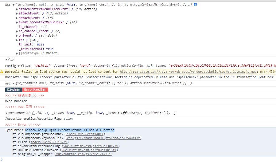

Hello, may I ask if I am in JavaScript. Introduced sdkjs plugins/v1. plugins. js in DocumentServer and attempted to write strings into the editor using the “window. Asc. plugin. executeMethod” (“InputText”, [“ONLYOFFICE Plugins”, “ONLYOFFICE for developers”]; "method mentioned in the plugin documentation. But when I was executing the method, I reported an error: window.Asc.plugin. executeMethod is not a function. Then I printed out the window. Asc. plugin object without seeing the executeMethod method. May I ask which step I made an error in.
Hello @isfifia
Possibly the issue is that the structure of the plugin is incorrect. Please take a look at it here:
https://api.onlyoffice.com/plugin/structure
As a reference, you can check out sample plugin Search and Replace in which also executeMethod is used:
https://api.onlyoffice.com/plugin/example/searchandreplace
On the example page you can find a link to GitHub where all plugin code can be found.

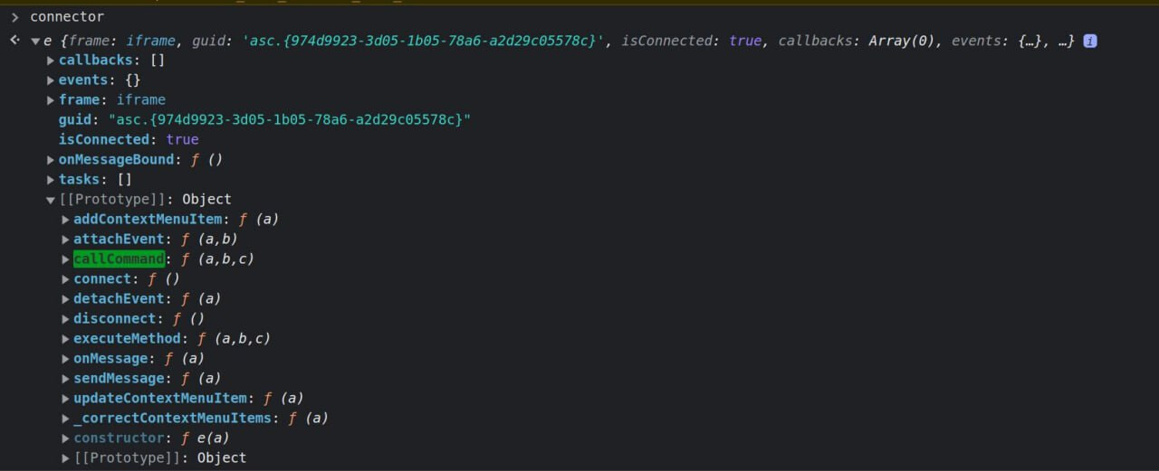

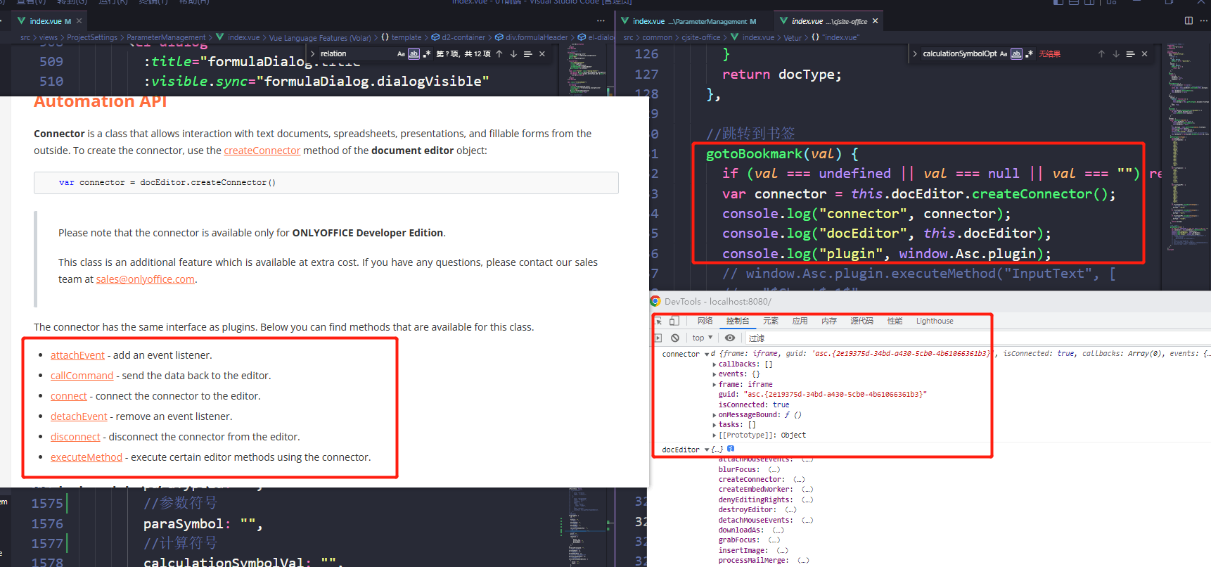

I created a connector object using var connector=docEditor. createConnector(), but the resulting object seems to be different from the one on the document。
Hello @isfifia
Sorry for the late reply.
In the documentation all methods are listed. In the console you can find these methods by enlisting [[Prototype]] array of the connector object:
Since you have Developer Edition trial license now, you can also contact us via onlyofficesupport.zendesk.com to get prompter replies.
