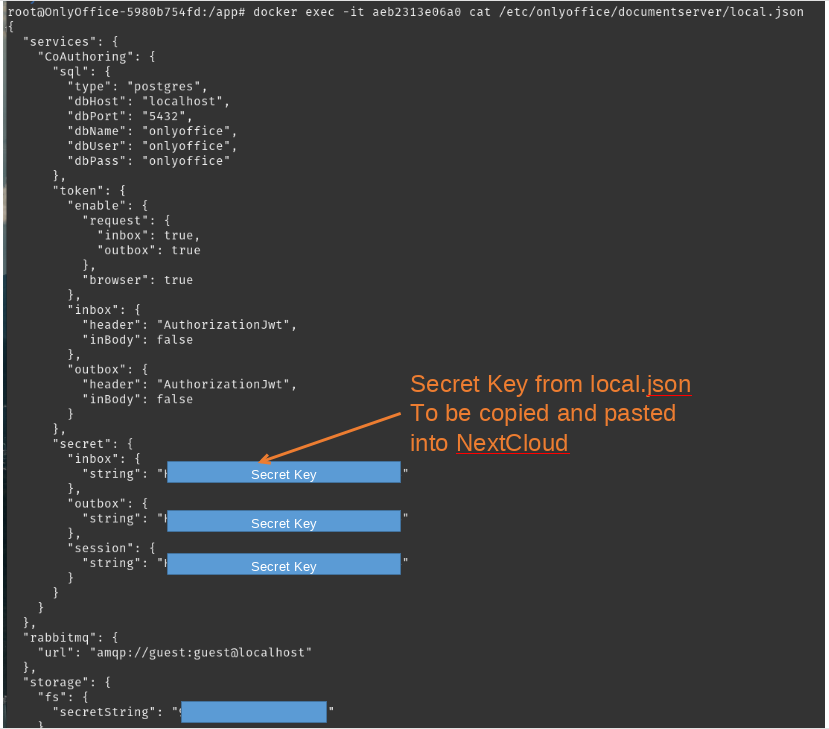

Thanks Carl for the reply.
Here are my steps so far.
Checking the docker container ID from the command line: docker ps -a
View of the default local.json file.
Pasting the URL and secret key into NextCloud.
Picking of the following error message, in NextCloud.
“Error when trying to connect (Client error: GET https://onlyoffice.www.myURL.com/healthcheck resulted in a 404 Not Found response:”

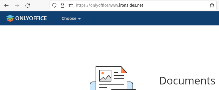

What is the URL you are entering in the Docs address field of the connector? Please copy this URL, paste it to the address bar of the browser and make a screenshot of the page that is opened there.

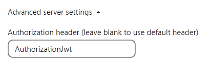

Also note that you need to set the authorization header as AuthorizationJwt in advanced server settings section of the connector settings:
Hi Carl,
Thanks for the reply.
Here is the URL, screenshot.
Best,
Alex
Hi Alex, thanks for the screenshot.
The address you are entering is the address of ONLYOFFICE Workspace, not Docs. You need to install a separate Docs instance following one of the available guides depending on the preferred installation type and then connect it to your Nextcloud.
