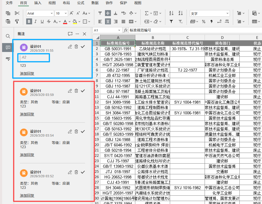

When using the automation API to add annotations in OnlyOffice, it works in Word but encounters issues in Excel. The annotations are not bound to the cells. What could be the reason for this?
The content within the blue box was added through OnlyOffice, while the content within the red box was added through Automation API

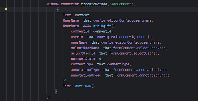

This method is useful, but previously when I was working with doc documents, I could pass a custom parameter, UserData, through AddComment to save the business data I needed to use. When needed, I could retrieve this parameter through annotations. However, after switching to this method in Excel, I can no longer pass custom parameters. Is there a more suitable approach?
