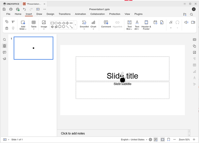

Video in presentation shows black square and is not playable
  • OnlyOffice version: Community Edition 9.0.4.50 (deb)
  • OS: Arch Linux 6.16.8-arch3-1 (64-bit)
  • Video format: MPEG-4 (Codec: H.264)
When I insert a video into a presentation, it only displays a black square as the preview image. A player bar appears below, but the video itself cannot be played.
Is there a way to fix this issue or enable video playback in presentations?

Unfortunately, the problem still persists even with the newer version of ONLYOFFICE Desktop Editors.
I also tested the AppImage version available in the official download section, but the issue remains. When attempting to play a video embedded in a presentation, the following errors appear in the terminal:
(DesktopEditors:43217): GStreamer-WARNING **: 10:38:30.814: External plugin loader failed. This most likely means that the plugin loader helper binary was not found or could not be run. You might need to set the GST_PLUGIN_SCANNER environment variable if your setup is unusual. This should normally not be required though.

I am also having this problem.
I do have GStreamer installed.

Trying to run onlyoffice. The “libva error” shows up as soon as open office starts - before I select the presentation editor, which itself is before I try inserting the video.
$ onlyoffice-desktopeditors --gstreamer-debug-level=2
(DesktopEditors:17677): Gtk-WARNING **: 22:39:58.437: gtk_disable_setlocale() must be called before gtk_init()
libva error: vaGetDriverNames() failed with unknown libva error
^C
It should also be noted that if double-click the video files in XFCE file explorer, they open and play outside of OnlyOffice just fine
