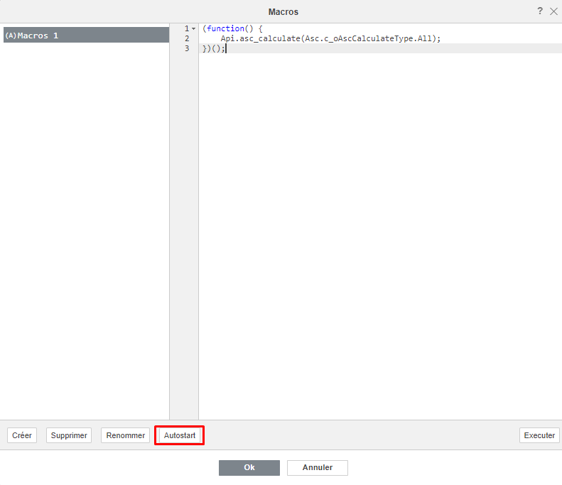

- You can also use a macro that will automatically update values when the table is opened.
Also, don’t forget to check the autostart option. (The fastest way)
Script:
(function() {
Api.asc_calculate(Asc.c_oAscCalculateType.All);
Recalculate worksheet values
Hello Nikolas,
Thank you for your reply.
Pressing F9 works, but the macro in autostart mode does not.
