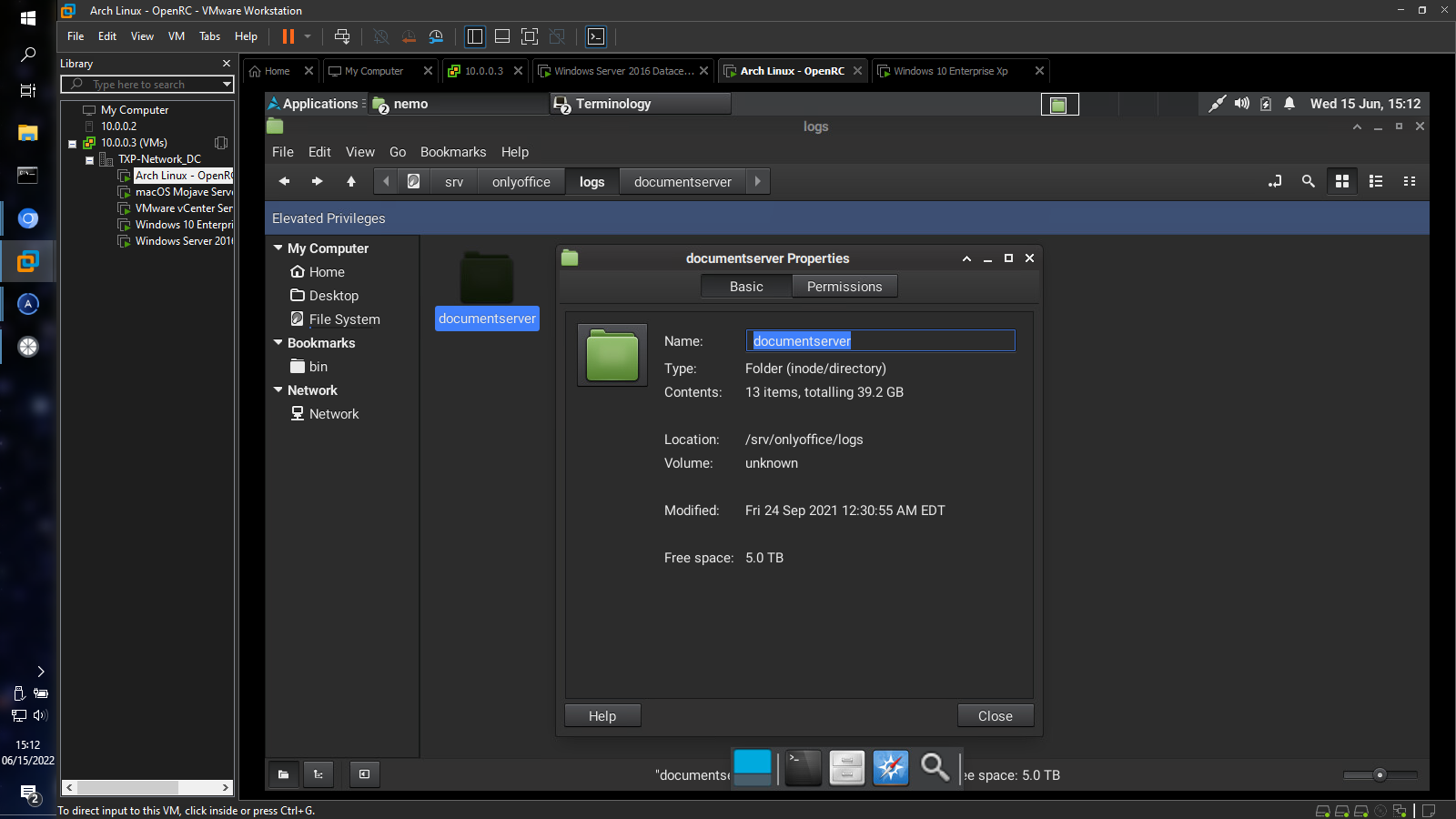

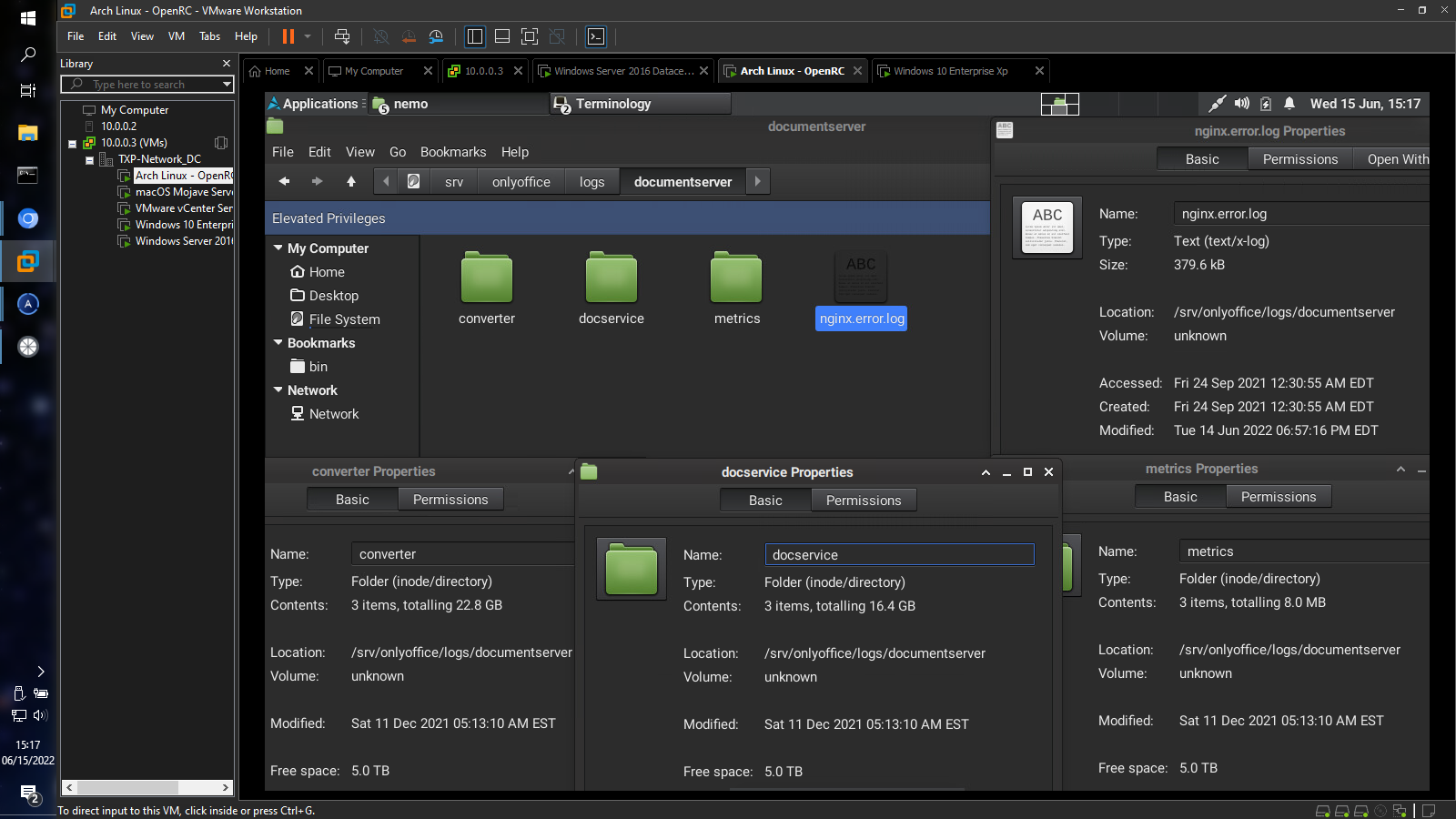

The logs from that folder are very large. I’m not sure how to attach them here. The Nextcloud instance is sitting behind a VPN, so I can’t share them with you from the instance I’m hosting.
More info:
Would you like for me to pull a specific file from one of the folders, if applicable?
Hi, there must be something wrong with your Document Server container because the log folder must not have such a giant size. Please reproduce the issue with saving the connector settings and provide the output of tail -20 /srv/onlyoffice/logs/documentserver/converter/out.log
