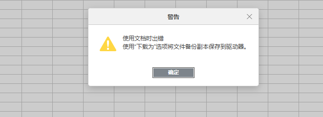

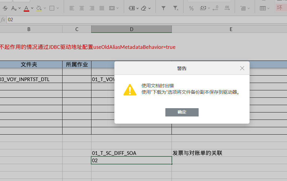

@DmitriiV @Constantine Hello, I also encountered this issue while retrieving external data and backfilling it into an office document, as shown in the error message
I checked the Docker container path and don’t know which log to send to you. Can you explain it?
system version: 8.2.2.22, which is deployed with docker

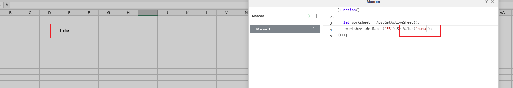

hello,
1.I don’t use the proxy;
2.I integrate the document server with vue frontEnd in my application;
3.I can edit the file in Integrated Example and can set the value wit macros.You can see the picture below.
Is there a problem with my document server options config?
Please provide your full Editor’s initialization config used in your Vue app
I haven’t config key and callbackUrl,is this reason?
For the full-scale integration of your own application with Document Server the key and callback are required for documents to be opened and saved, please check out these guides:
Additionally, please refer to the implementation on the Integrated Example (it should be available at documentserver_url/example after you run the command from documentserver_url/welcome page). Alternatively, you can install Vue Example and check the Vue implementation there - Vue | ONLYOFFICE
