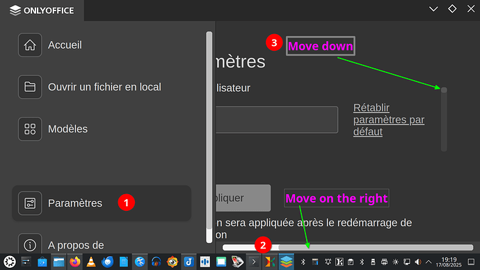

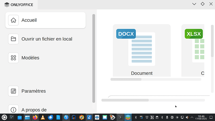

I tried a lot of things saw in the Internet in order to solve this classical issue but nothing works : the interface is too big so OnlyOffice can’t be used.
I tried many sources (flatpack from DISCOVER, .deb and appimage from official website) and many files configuration (settings.xml, .desktop).
If you have a solution you will save my day (and more) ! :slight_smile:
Thanks for help.

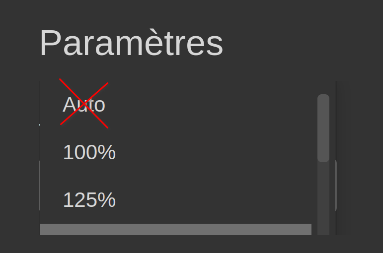

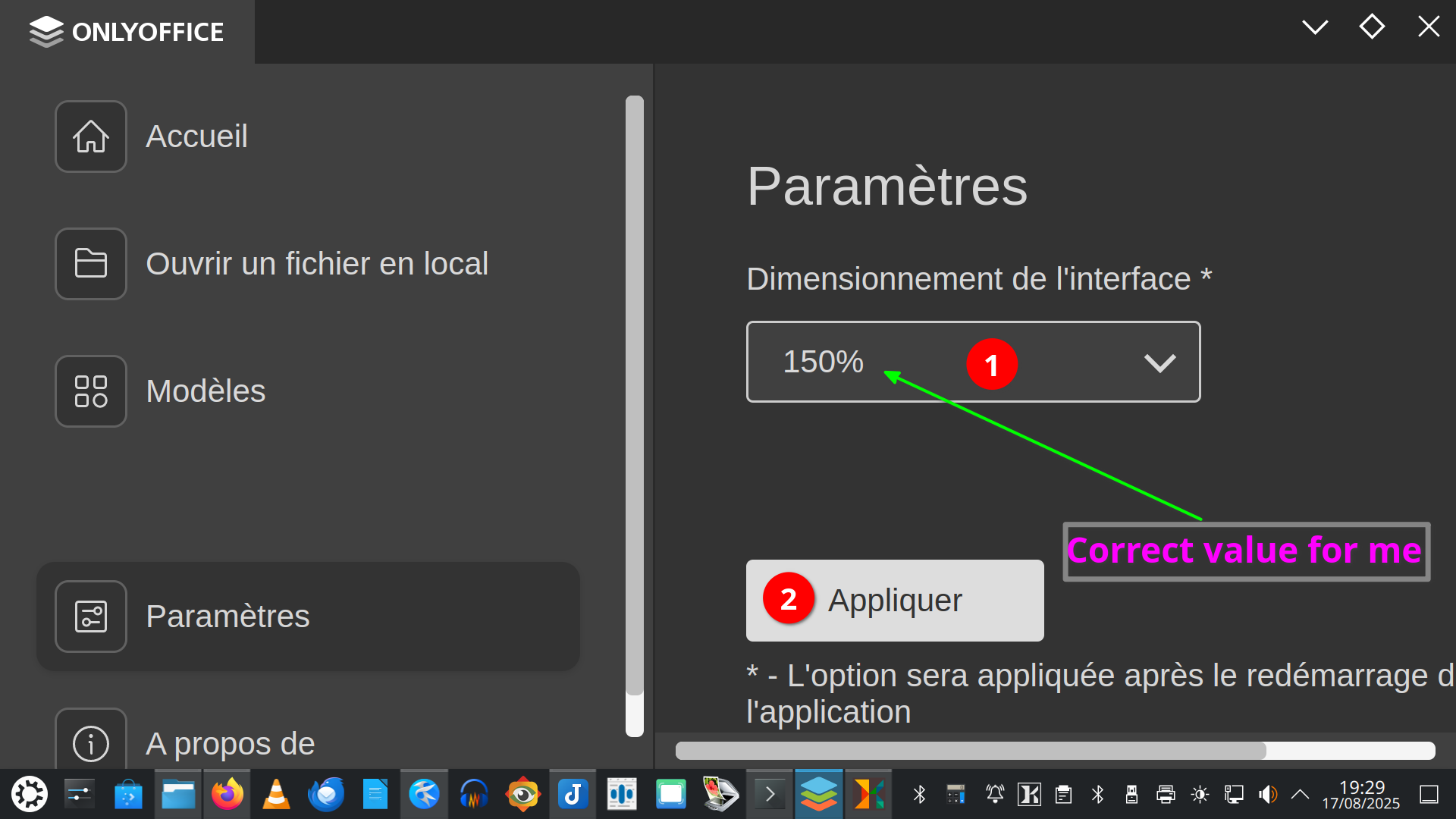

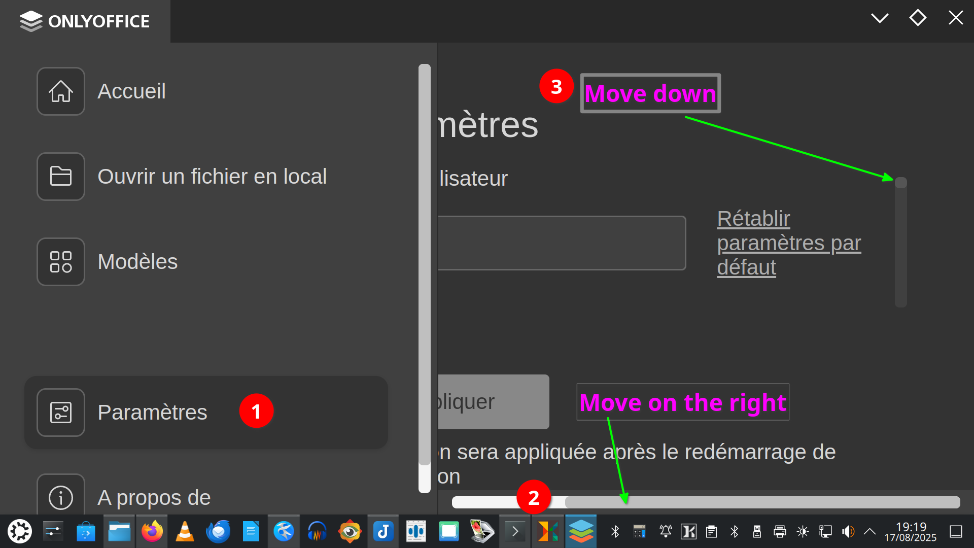

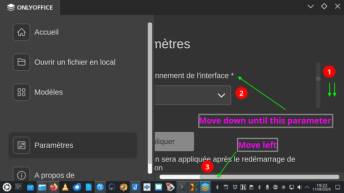

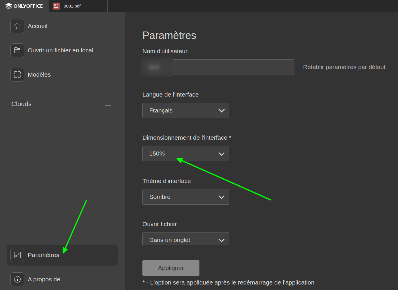

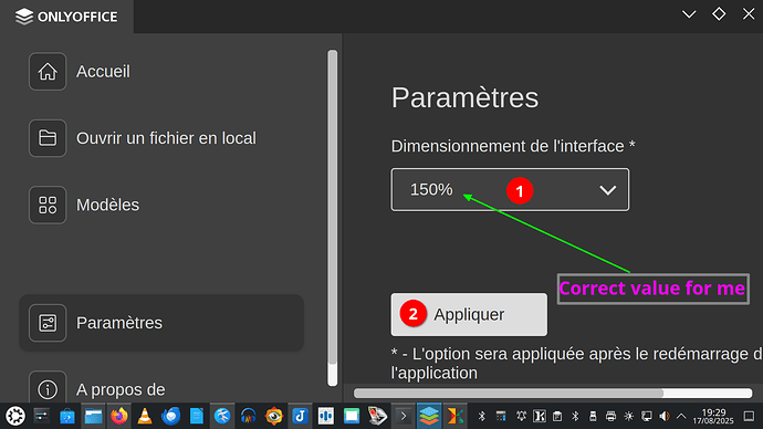

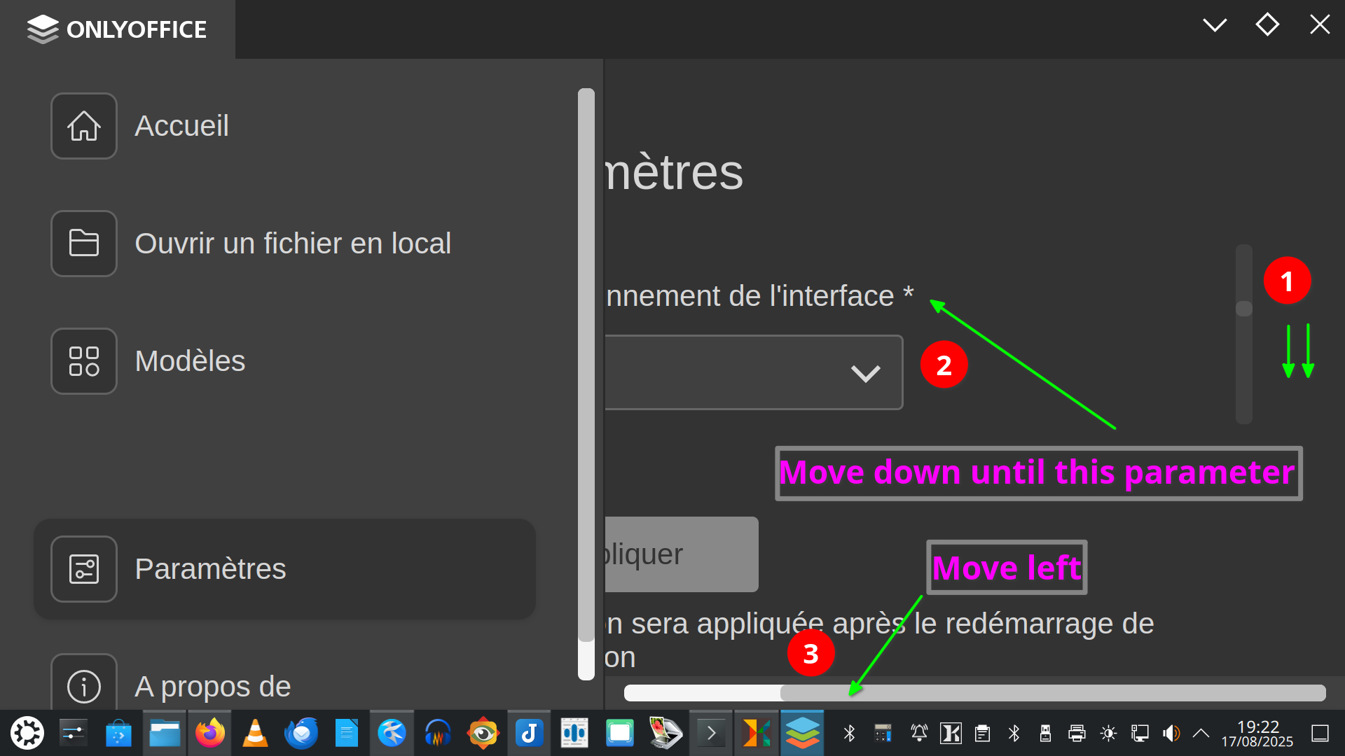

After one day of search, I found my solution…
And that’s it !!!
The “auto” value (by default) was not a good thing for me !!!
