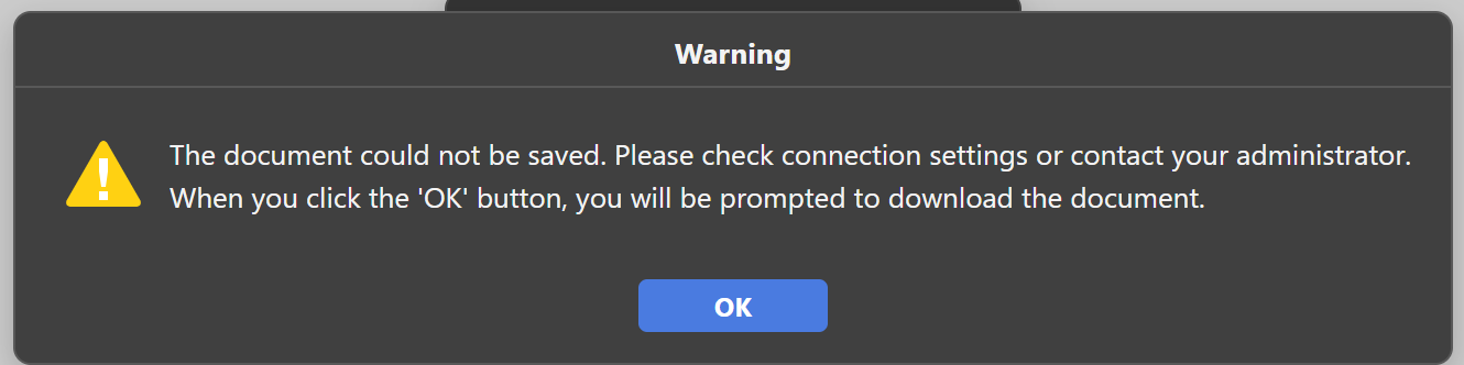

The document could not be saved. Please check connection settings or contact your administrator. When you click the 'OK' button, you will be prompted to download the document
Following the instructions at Running ONLYOFFICE Docs using Docker Compose, I deployed the document server using Docker Compose. After running it, I tried accessing example, but the file wouldn’t open. The Docker logs show the following:
[2026-03-22T15:08:02.478] [ERROR] [localhost] [192.168.192.1new.docx1774191307984] [uid-14] nodeJS - postData error: url = http://192.168.50.10:9001/example/track?filename=new.docx&useraddress=192.168.192.1;data = {“key”:“192.168.192.1new.docx1774191307984”,“status”:4,“actions”:[{“type”:0,“userid”:“uid-1”}],“token”:“eyJhbGciOiJIUzI1NiIsInR5cCI6IkpXVCJ9.eyJrZXkiOiIxOTIuMTY4LjE5Mi4xbmV3LmRvY3gxNzc0MTkxMzA3OTg0Iiwic3RhdHVzIjo0LCJhY3Rpb25zIjpbeyJ0eXBlIjowLCJ1c2VyaWQiOiJ1aWQtMSJ9XSwiaWF0IjoxNzc0MTkxOTUwLCJleHAiOjE3NzQxOTIyNTB9.yz9MZSnvdEwwxqrD6LTtpasG9ntCMgA9XxGrvTUhiHo”} Error: connect ETIMEDOUT 192.168.50.10:9001
The error in your logs — connect ETIMEDOUT 192.168.50.10:9001 — means that the Document Server container cannot reach the example application at 192.168.50.10:9001. When a user closes a document, the Document Server sends a saving callback to the callbackUrl provided by the example app. If this callback request times out, the document cannot be saved and you see the warning in the screenshot.

I switched to using host-gateway in Compose, and that solved the problem. Thank you.
