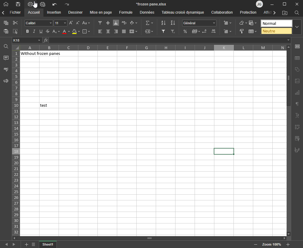

Hi all
I did a test this morning and recorded it.
Conclusion :
  1. without frozen panes, the last position is remembered ( I did not checked the precision).
  2. with frozen pane, the last position is not remembered.
    editors_20231014-10h13min57s
