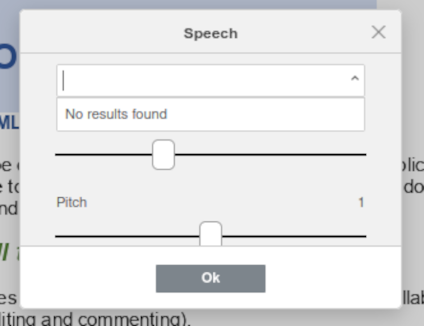

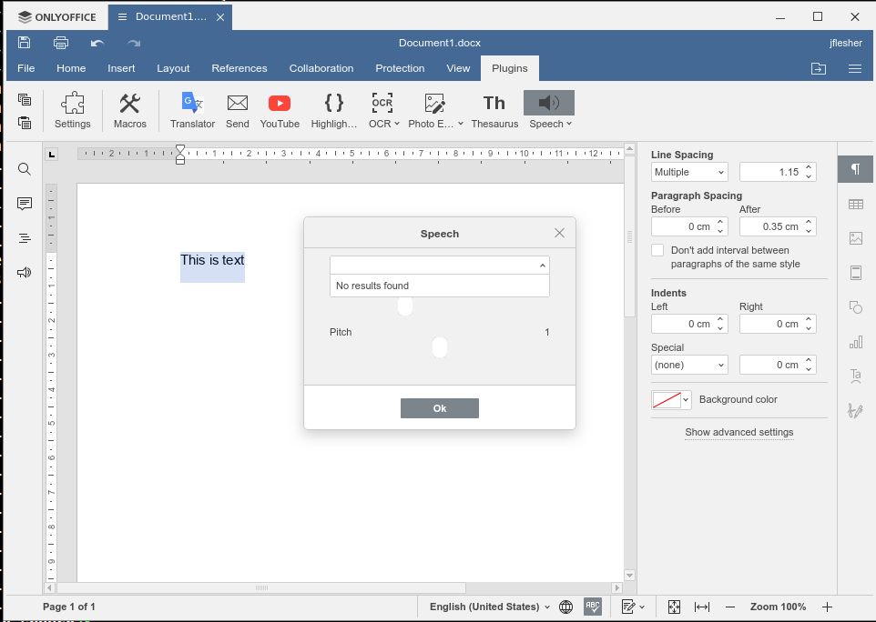

This is on my online, only office account and my desktop app as well, using Linux Manjaro KDE Firefox 103.0.2, also did not work in Chrome, in settings it has a dropdown, it is empty, and it is not working after highlighting text and pressing start, so I guess this is why. I set media.webspeech.recognition.enable to true with no help, I have a Read Aloud plugin for Firefox that works fine, does anyone know how to fix this?
Hello @flesh
Please clarify the product you are using. Personal (https://personal.onlyoffice.com/), Workspace, stand-alone Document server?
Also point me to the guide which you used for plugin installation.
As for the issue in general, please check that issue reproduces in different browsers (also, try to clean browser cache and cookies).
Also please make a screenshot of the issue.
I am using Personal, and Workspace online at onlyoffice
I tried Firefox, Chrome, and Brave, but only in Opera do I get something in the box, but it does not work.
For my Desktop, I used this Plugin guide ONLYOFFICE
This works fine in Windows, just not Linux Manjaro.
Thanks

Hello @flesh
We ran a few tests and figured out few things.
About Google Chrome (AUR) browser. The plugin should work with that browser out-of-the-box without any additional actions. Could you please try to reinstall Chrome and re-check the situation?
About Firefox browser. Manjaro OS uses ‘voices’ as default speech synthesis system. For some reason, Firefox doesn’t work properly with that system on Manjaro.
Workaround solution is installation different speech synthesis system (for example, festival or espeak-ng) and set it as default system.
