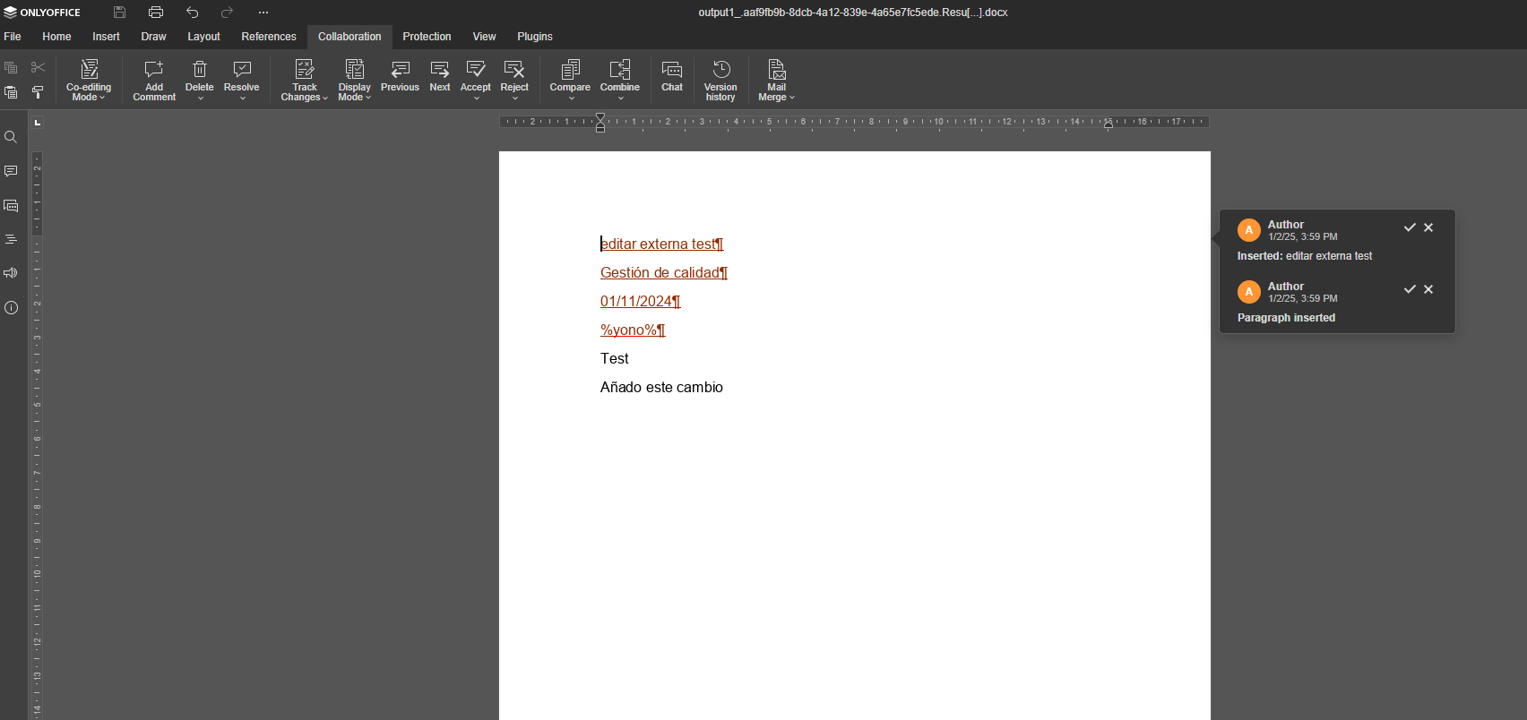

Hi,
The document comparison works without problem in the web editor of ONLYOFFICE community edition as you can see in this image:
I’ve uploaded the output1 file and them compared it with output2 using “Document from file” option.
Thanks
