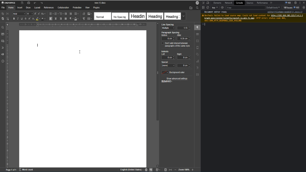

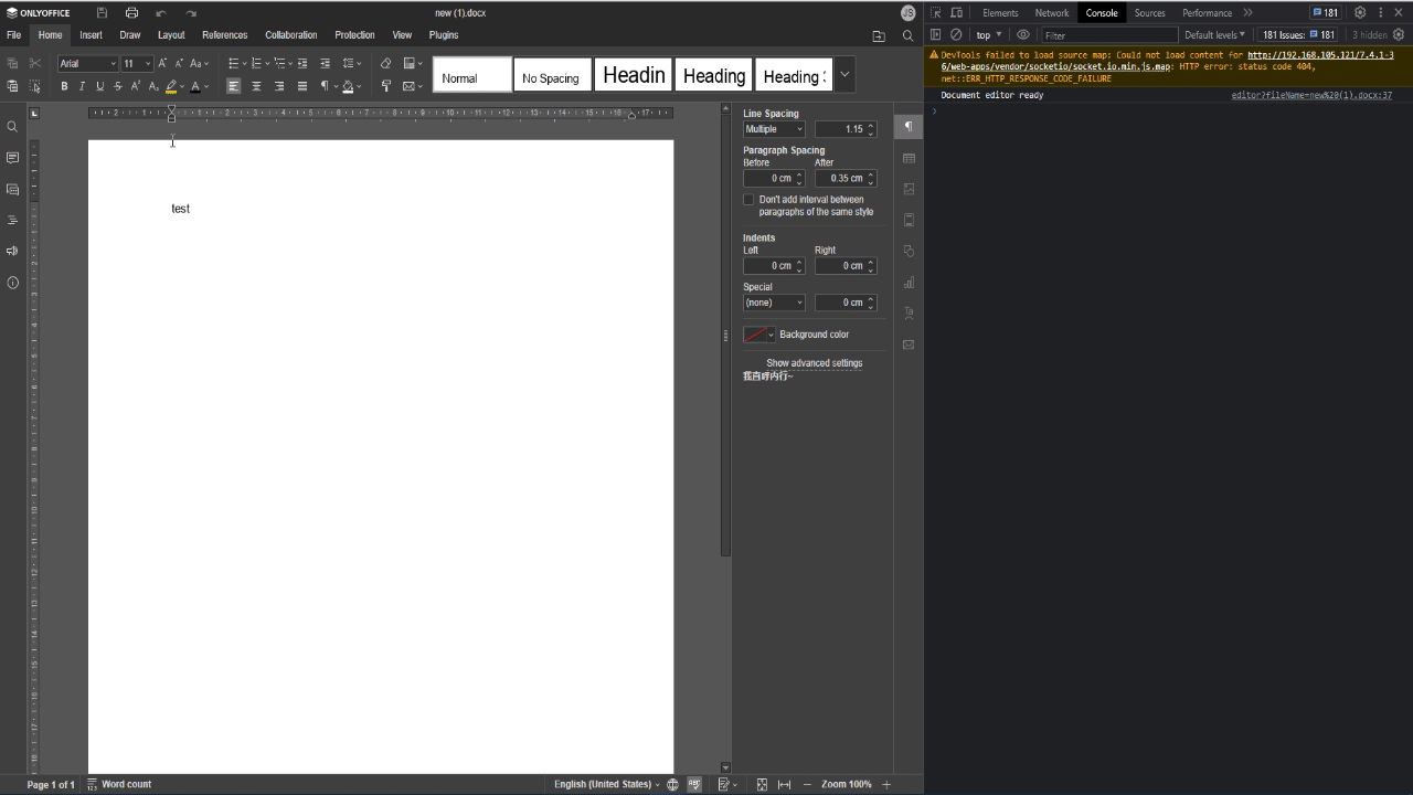

hello, I have a question. It looks like a bug. I can’t change the name of the document, But it seems to be working fine.
What I use is java-spring example.
There were no abnormal logs during the whole process
