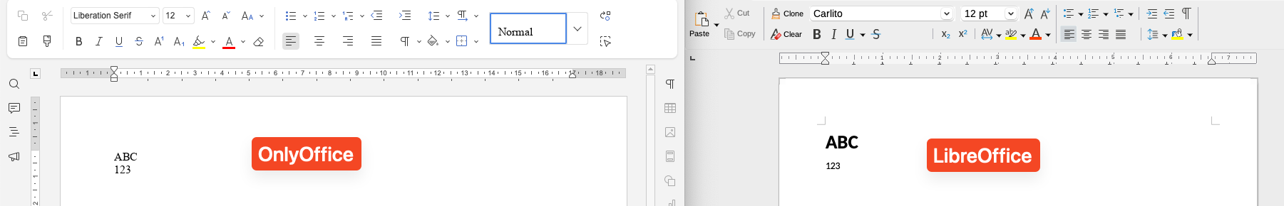

To test, simply create a heading and some normal text, like:
ABC
123
Where you make ABC the heading.
Then color that ABC red.
Select all text, and click on the ‘Clear Style’ button, or in LibreOffice it is called: "Clear (Clear Direct Formatting ^M).
In OnlyOffice, all text is reset to ‘Normal’ text.
In LibreOffice, the ‘ABC’ is reset to a clean Heading. The 123 remains clean ‘Normal’ text.
