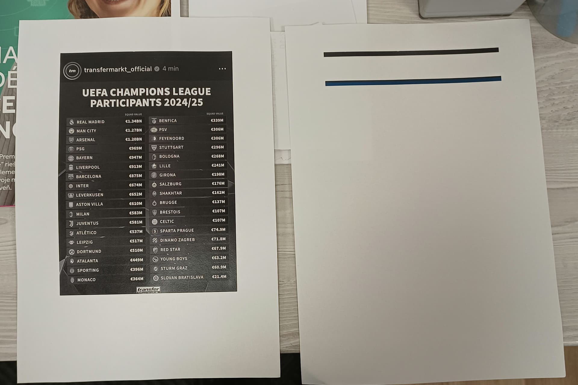

i have tried: two computers/notebooks Windows 11 Education, two printers: xerox c7100, c7025, printing over network,

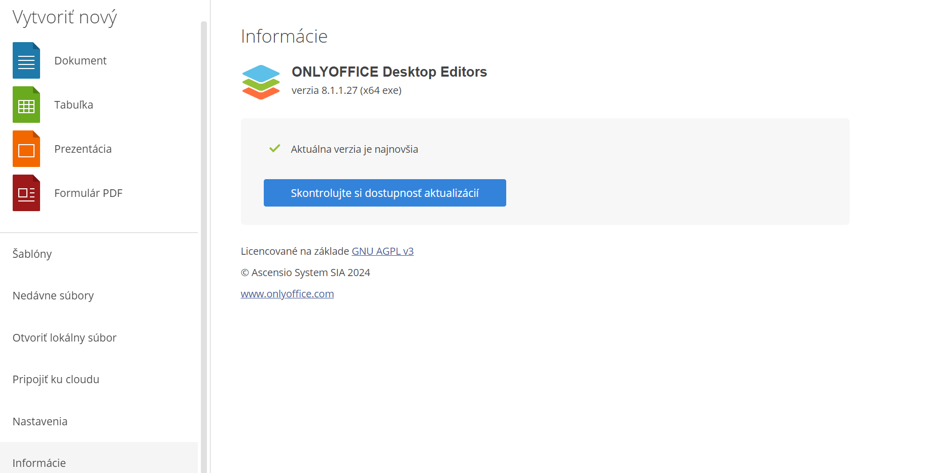

version: ONLYOFFICE Desktop Editors, verzia 8.1.1.27 (x64 exe), images are not printed or printed poorly
Printing PDF is OK
I am sending a picture in the attachment, on the left a print via PDF, on the right a print via Onlyoffice Dokument
