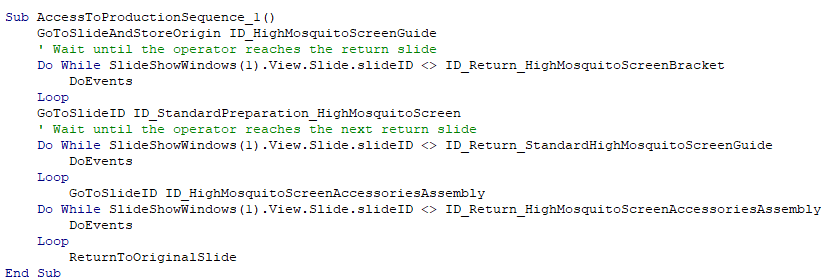

For example, one of my VBA procedures works as follows:
As shown in the attached example, the macro stores the current slide, navigates to different procedure modules, waits until predefined slides are reached, and then redirects the operator to the next required section before finally returning to the original slide.
This allows a single presentation to contain multiple assembly workflows assembled dynamically according to the operator’s choices.
