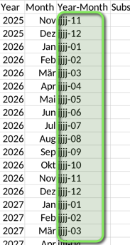

Here the file. Instruction of the file.
  1. Table “Total Monthly Growth”
  2. Column C shows jjjj-11 (as described in my first post)
  3. After pushing F9 the column gets calculated automatically.
Similar to Table “Prepared-Data”
Subscriber Growth Anonymous.xlsx (105.3 KB)
Here the printscreen for proof :slight_smile:
Thanks for your help!

I dug very deep, and found the following in the sample spreadsheet. (this is from the XML data that is the building blocks of the sheet)
<c r="C2" t="str"><f t="shared" ref="C2:C27" si="0">TEXT(B2,&quot;jjjj-MM&quot;)</f><v>jjjj-11</v></c>
What it says is Cell C2 has a formula of TEXT(B2,“jjjj-MM”) and a value of “jjjj-11”.
This seems to be indicative of why fields have “j” characters instead of the year value. I could find no reference to “j” being a date format rule character, unless Marix has some knowledge of one.
But the cells have values, and with no catalyst, as mentioned previously, no recalculation on open will occur, and it would appear, that the value of “jjjj-11” is a valid result of the formula.
I hope this may provide a little insight to your issue.
Thanks for the summary. “jjjj” refers to the German year reference.
I did suspect as much.
But it would seem that OnlyOffice does not recognise “jjjj” as a functional equivalent to “yyyy”, thus treating it as a string literal and returning it as such.
To me, it would appear that if you used TEXT(B2,"YYYY-MM") instead of TEXT(B2,"jjjj-MM") in your cell formulas, you may get the output that you seek.
