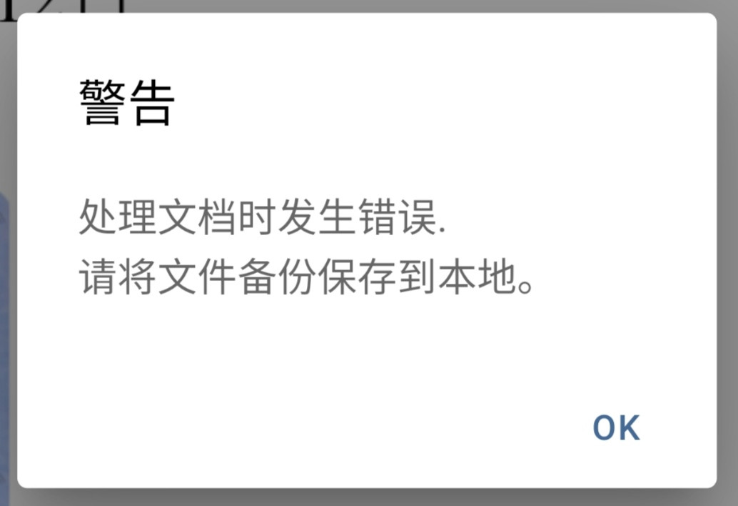

Hello, I encountered the following error when using onlyoffice docs on my mobile phone: “Warning: There was an error when processing documents. Please backup and save the file locally.” (See the following figure for details)
I also recorded the logs on the server here:

Could someone tell me if there is a problem with my configuration? This will be appreciated!

Glad to receive your reply @Constantine
Let me describe the details to you:
Operating environment: Nextcloud 25.0.3 + Onlyoffice 7.3.0 build 184
Software used: Nextcloud Android mobile app 3.23.0 or mobile browser (I use Xiaomi browser)
Use process: according to the process of opening or creating office files normally, after a period of normal use (about 1 minute, sometimes dozens of seconds), I will pop up the above warning prompt
This is the log record on the onlyoffice docs server during this test.

Jackson:
Is it possible to record a video demonstration of this scenario from your device?
Also, please try to reproduce the issue on any other mobile device and from PC.
sorry! @Constantine I am busy recently. Didn’t reply to you in time! How can I send the recorded demo video to you?
Hello again @Jackson
You can upload the video to any storage and share link to the file.
If there is any sensitive data in the document then you can send the link via PM.
link
Thank you very much!
Thank you for the video.
Have you tried to reproduce this issue in any other browser, e.g. Chrome or Firefox, or on the PC?
Additionally, please specify the model of your smartphone, Android version and version of used browser. It is Xiaomi browser, isn’t it?
I tried to use the mobile phone simulation of Chrome browser and Microsoft edge browser (both Android and Apple ios have tried), and the results are the same, but if it is the computer version of the editing mode, this problem will not occur! Here are the details you need for my demo video:
Xiaomi 11ultra
Android 11
The Xiaomi browser included with the mobile phone is used, version: 17.4.220216
Seems like this is unordinary issue - I wasn’t able to reproduce it.
Is it possible to provide us a test account on your Nextcloud portal to check out the issue?
Of course! You already know my nextcloud website! You just need to go to its homepage and click to register an account, and I can pass the approval!
I’ve sent a request. Please check it out.
Thanks for confirmation. Indeed, was able to reproduce the issue.
We are checking the situation. I will update this thread once any news come up.
We ran some tests and have found out that Document Server Community Edition is malfunctioning when mobile editors are used. This bug was registered in our internal tracker under the number 61396. Our team is already working on it to fix it as soon as possible.
Thank you for pointing to this issue and please accept our sincere apologies for the inconvenience caused.
@Constantine It’s my honor to make contributions to Document Server, and I hope to bring everyone better products
We have just released version 7.3.3 of Document Server where mentioned bug 61396 is fixed.
Please update your current instance and check the situation again.
Thank you very much @Constantine , I will try it immediately!
