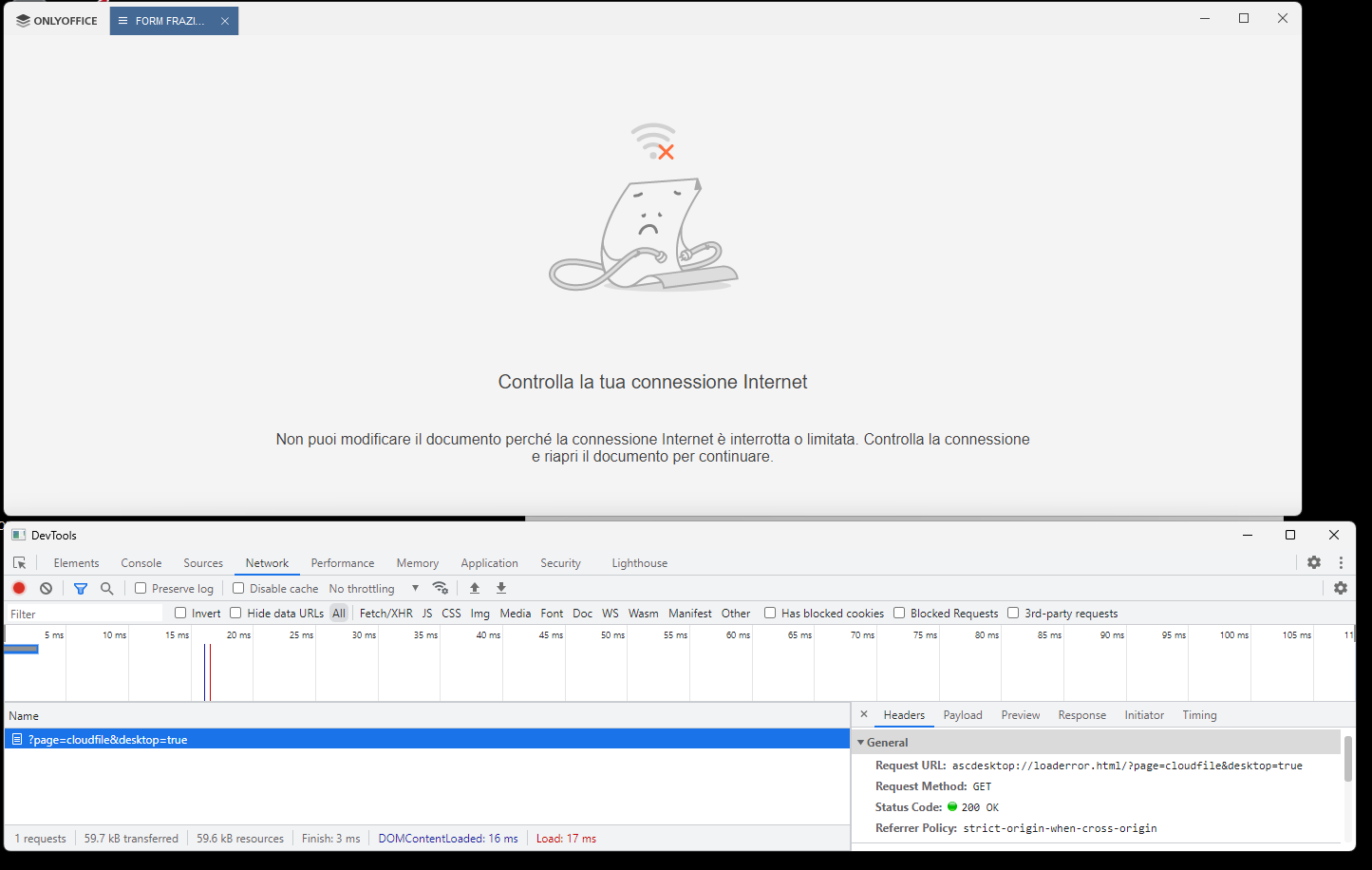

We’ve recently started installing OnlyOffice Desktop Editors on our clients’ PCs, and everything has been working well. However, on some PCs, we’re encountering a strange issue:
(Translated from Italian)
“Check your internet connection. You cannot edit the document because your internet connection is interrupted or limited. Check your connection and reopen the document to continue.”
This happens with every document, even local ones. Creating a new blank document also triggers the same error.

Sorry for the late reply. The described situation looks strange. Could you please enable debug mode and reproduce the issue? Running in debug mode on Windows | ONLYOFFICE
We need to take a look at Console and Network tabs in the debug mode once the issue is reproduced.

I’ve launched onlyoffice in debug mode as you said, and found nothing in the network tab apart from “ascdesktop://loaderror.html/?page=cloudfile&desktop=true” with status code 200 OK
I’ve also took a look at editors.exe with ProceXp64 to see which servers was onlyoffice connecting to and apart from “server-3-165-255-36.mxp53.r.cloudfront.net” which isn’t blocked, the app wasn’t connecting to the internet.
Reinstalling AND removing ProgramData\ONLYOFFICE and %LocalAppdata%\ONLYOFFICE solves the issue.
We’re running Windows 11 24H2.

The dev console still shows nothing, just like in the last screenshot on this post.
