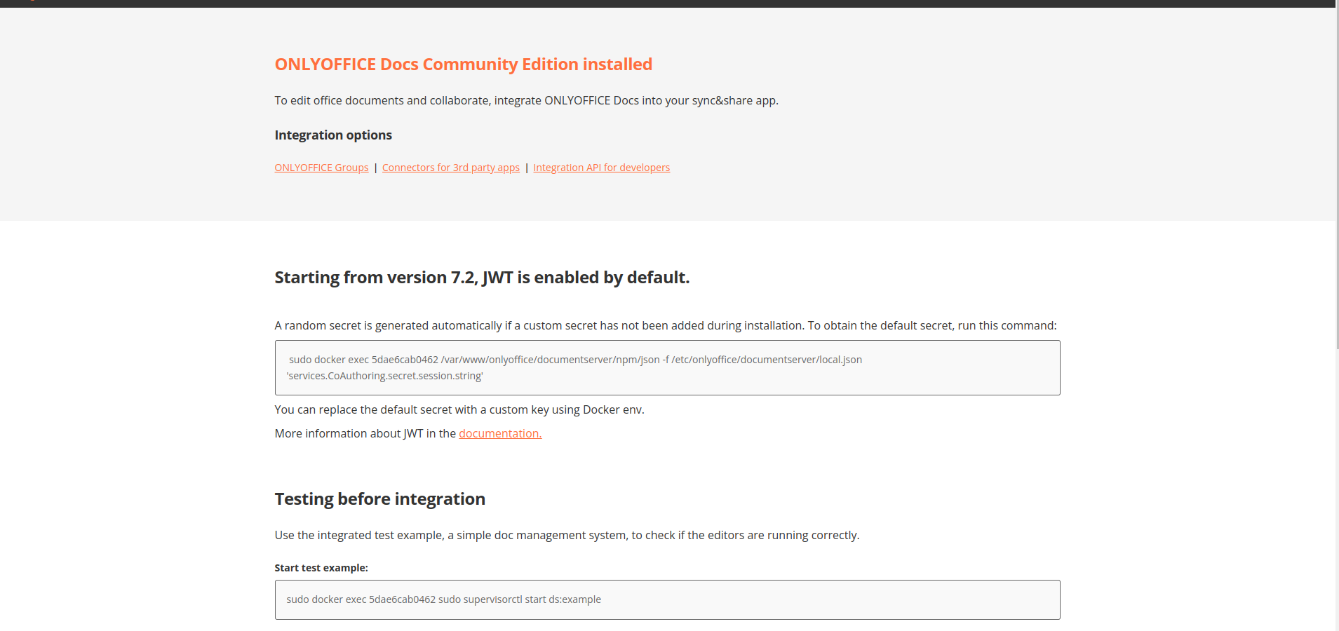

Hello, thanks for the answer.
  1. Yes, 2 containers with nginx and OO are in 1 network.
  2. Yes, when I enter https/my.domain.com/onlyoffice/ in the search bar, a redirect occurs to
    https://my.domain.com/welcome/
    , where I see a message that ONLYOFFICE Docs Community Edition is installed
    below I will attach the necessary screenshots about the redirect and after which files exactly the launch of OO docservice stops (after index_loader)

But you did somehow reach your OO-installation before? You made a screenshot of the welcome page. If it’s getting redirected, that is a good sign already. But why it has no content now? We need to know that OO is up and running. Then it’s probably a proxy problem. As I mentioned before, I don’t deal with react, that I can’t help you with. Usually you can catch misconfiguration with Debugging-Console as you can see where you browser is being redirected or what sources/addresses it gets back from the host.
You are not inside a cloud-hoster by any chance … like cloudfront?
EDIT:
When you access “https://my.domain.com/onlyoffice/” you always get redirected to “https://my.domain.com/onlyoffice/welcome”. To test if onlyoffice is running and accessible without your proxy you can try to access OO welcome page directly via “https://host/onlyoffice/welcome” from inside your network behind your proxy. If necessary adjust to the correct port you expose it on, for example “https://host:port/onlyoffice/welcome”. Once we know things are ok with OO, we can figure out the necessary proxy configuration to access it.
