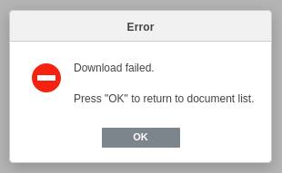

If I run the following on the ONLYOFFICE server:
supervisorctl start ds:example
And go to https://onlyoffice.example.com/example/ I get the “Download failed” 403 error when opening a document unless the Nginx return 403; line in /etc/onlyoffice/documentserver/nginx /includes/ds-docservice.conf is commented out, when it is commented out everything works without issues.
Does anyone have any suggestions regarding what else can I do to debug this problem?

I’ve solved the issue after finding this thread, on one server on which I have reinstalled onlyoffice-documentservers the secret string for filesystem access in local.json didn’t match the other secret strings and this can be fixed using the documentserver-update-securelink.sh script, perhaps this needs to be documented somewhere?
On other upgraded servers the /etc/onlyoffice/documentserver/local.json didn’t contain the secret string for filesystem access (the same secret string as used elsewhere in the file), for example:
  "storage": {
    "fs": {
      "secretString": "usieh0oeXe7Boo2aey4ieph0iey8paiqu"
Again this can be set using the script, for example:
documentserver-update-securelink.sh usieh0oeXe7Boo2aey4ieph0iey8paiqu
Perhaps something about this could be added to the troubleshooting or updating documentation?

We moved to use the docker param SECURE_LINK_SECRET which worked as expected. Our issue was just when we overrided the file local.json without overriding the NGING conf file ds.conf
I may just confirm that the 403 error is related to the difference between both values of SECURE_LINK_SECRET between ds.conf and local.json , maybe this helps someone who got the same issue.
Regards
Yes, the different data (secure link) in mentioned files provokes described issue.
Exactly this fixes the problem !
