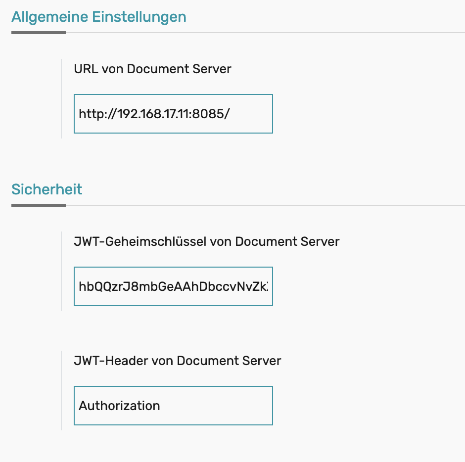

Additionally, please provide a screenshot of the settings of ONLYOFFICE app and let me know from where you are trying to open a document for editing.

As for the provided log, please go to Odoo portal > Settings > ONLYOFFICE > please make a screenshot of this page.
Also please make sure that the JWT secret and header match between Odoo and the Document server.
