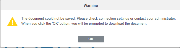

When I create or want to edit a document, OnlyOffice opens and displayed an error:
The document could not be saved. Please check connection settings or contact your administrator. When you click the “Okay” button, you will be prompted to download the document.

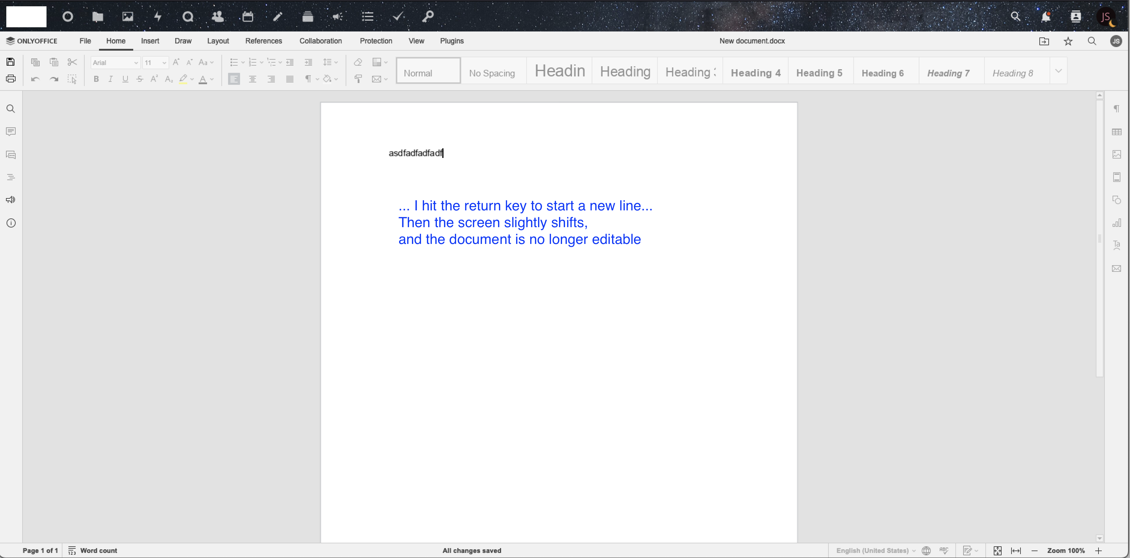

Also, I get this if I try and click into the document.
Screenshot 2023-08-24 at 10.35.14 AM
And a little more info, if I change “AuthorizationJwt” to “Authorization” as suggested in some guides, nothing works and I get this error on save.

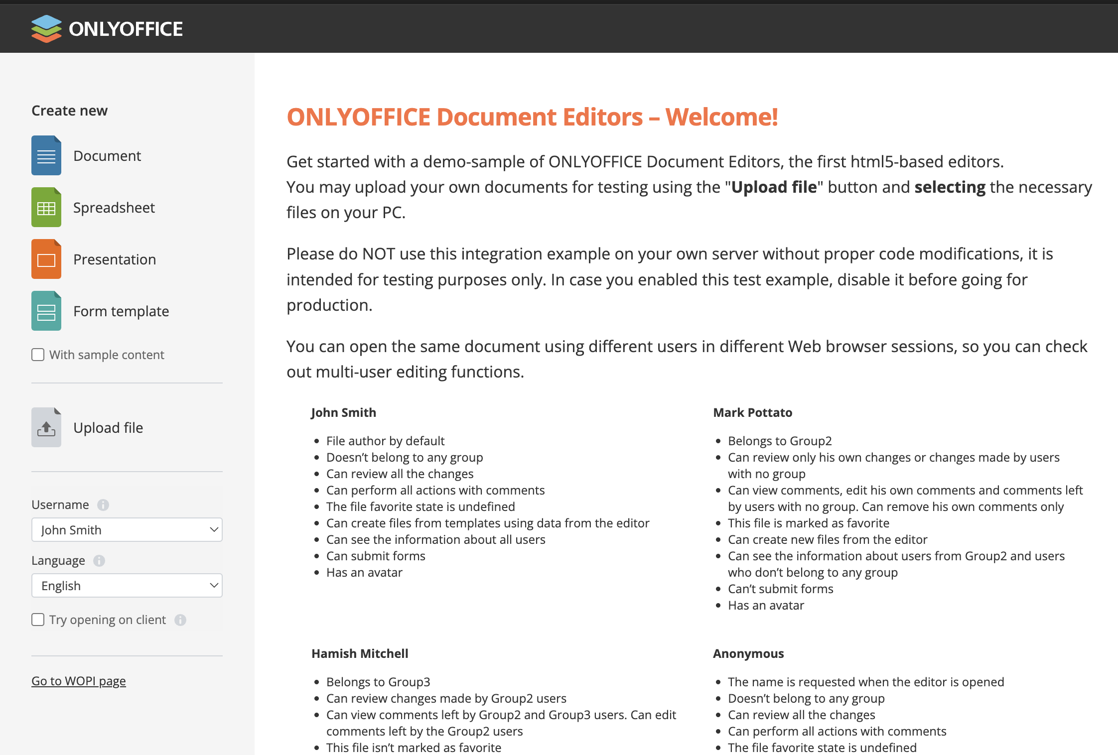

One more thing on this… I was able to get it to happen with a fresh install of OnlyOffice taking NextCloud out of the equation.
  1. I followed the install build CentOS instructions to a tee to build a fresh server instance (Installing ONLYOFFICE Docs for CentOS and derivatives - ONLYOFFICE)
  2. Run the ds-example from the welcome page
  3. delete all documents so that the screen just shows the information related to the 4 sample users
  4. create a new document and presto! Same behavior (See Attached screenshots).
