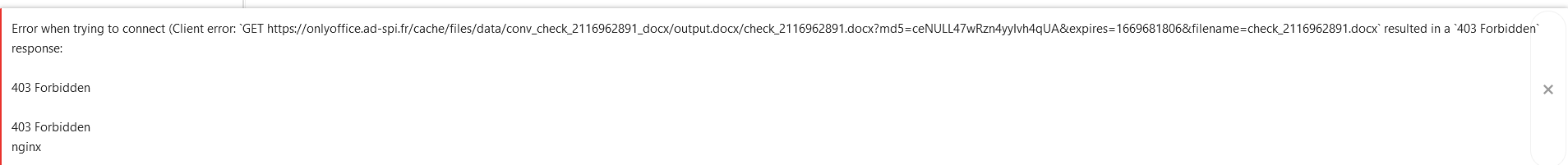

Hello, I absolutely cannot connect my nextcloud to my onlyoffice.
Hello @bilboox
To start off please execute a certain script from your machine where Document Server is installed:
For Windows execute documentserver-update-securelink.bat script that is located in C:\Program Files\ONLYOFFICE\DocumentServer\bin
For Linux execute command bash documentserver-update-securelink.sh

Yes that was fine, I ran the script and everything worked fine afterwards Thank You !

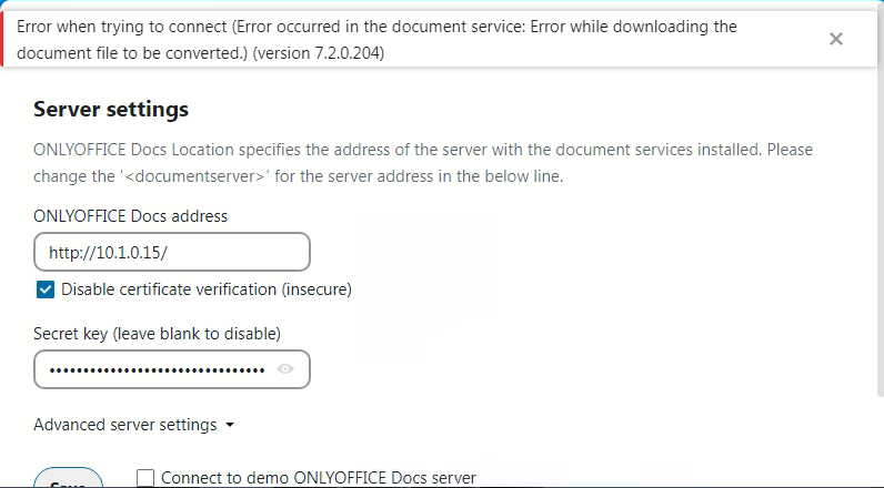

I got same error on my nextcloud Version 25. i used connector version 7.8 and document server version 7.2. i can access document server via http://10.1.0.15/, and nextcloud server http://10.1.0.10. But i can’t connect onlyoffice integration on nextcloud. Kindly help me when you free. Thanks
Please do not duplicate posts in several threads. I’ve answered you in the other thread:
