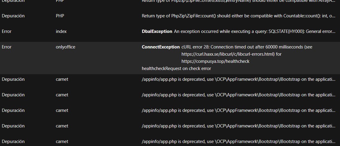

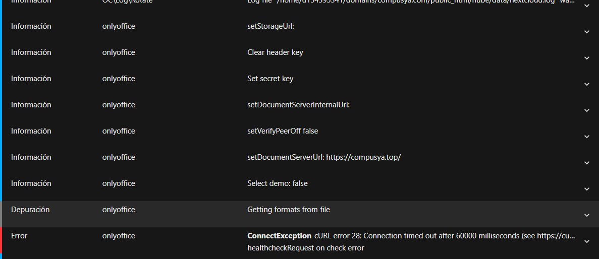

Additionally, please open connector app settings, hit Save button again and then check Nextcloud logs for any error entries related to ONLYOFFICE. Share a screenshot of those.

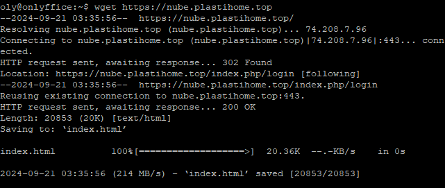

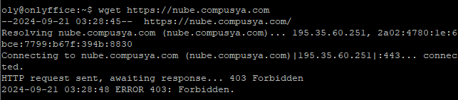

Please check mutual availability of Nextcloud and Document Server with wget <address> from one server to another and share the outputs.

this is on another server that i have mounted
Sorry for the delayed response, it can be seen that for some reason your Nextcloud is not reachable for Document Server. First of all, please make sure that Nextcloud is reachable on your side

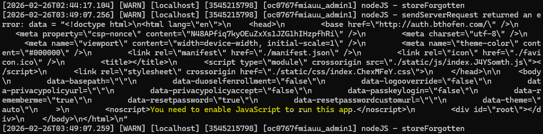

but, from the other log file, docservice/out.log, it says “you need to enable javascript…”
Do you use any browser extensions? Can you check out any other browser too?
