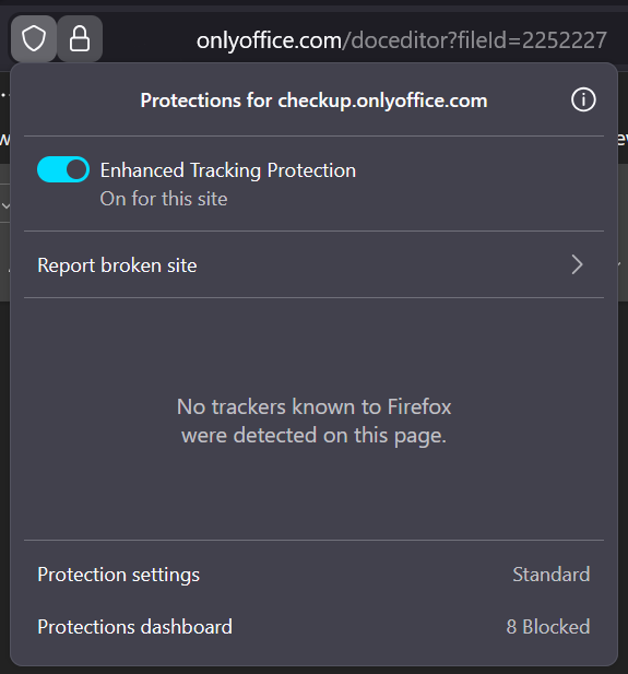

Please share similar screenshot from Firefox:
The shield icon on the left from address bar.
I also tried deactivating tracking protection. Unfortunately, Only Office still redirects me to the DocSapce page.
Is it possible to perform the same test from any other device or network? I cannot reproduce the same behavior in any browser.
