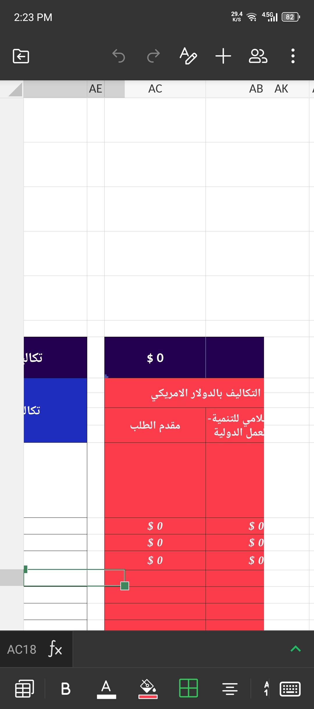

i use right to left language alot due to work and it seems there is a problem in layout as if it cannot read properly sheets that jave right to left loadout, so if you click on a cell it marks another one but fast double clicking that cell allows to modify its content, or if you try to resize a column it resizes another one

Thanks for the detailed report and the video — really helpful. We were able to reproduce the issue on our side as well. It looks like the Sheet Right-to-Left layout isn’t handled properly in the Android app.
We’re looking into this and will get back to you.

We’ve registered this behavior as a bug and it’s being looked into.
We don’t have an ETA for the fix at the moment, but we’ll update this thread once there’s progress.
