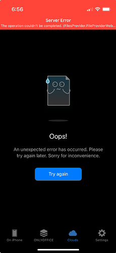

Additional information: after upgrading to this release, Nextcloud connection stops working… the 1st level of directories keeps showing, but entering a subdir raises an “unexpected error” (see the attached screenshot). Reinstalling and reconfiguring the app didn’t solve the problem. Even connecting via WebDAV to Nextcloud returns the same error! :frowning:

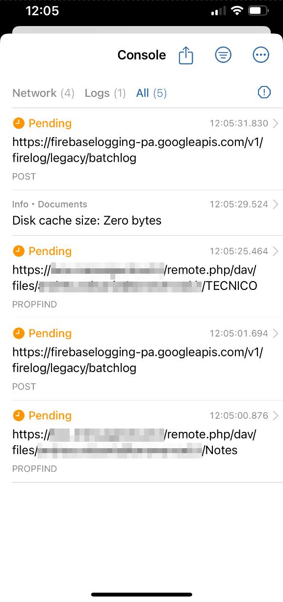

Please try to remove and re-add the connection to your Nextcloud portal again or reinstall the app completely. If it doesn’t help, please collect the app logs while you’re reproducing the situation, we will take a look at them:
Go to the Settings > About page > quickly tap on our logo several times > wait for the device to emit a characteristic vibration > go back to Settings menu > you will see a new Console option appear > go to Logs tab and check the latest logs.
Thank you @Alexandre . As I wrote, I already uninstalled an reinstalled the app. I also tried to connect with different Nextcloud instances (all of them in the 30.x branch), obtaining the same error. In the log I can see the “PROPFIND” request which remain in the pending state. Here it is:

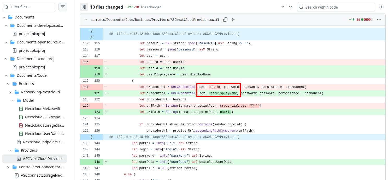

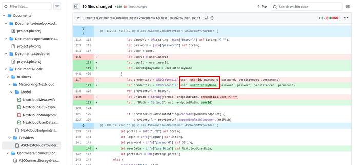

Thank you @Alexandre, I’m not a developer thus unfortunately I can’t contribute in a more effective way. The only thing I found clueless searching in the code is the change I noted in this commit (see the attached screenshot).

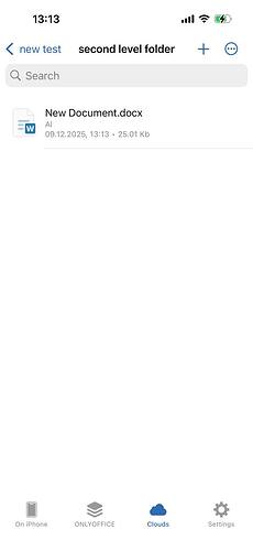

Dear @andrewhotlab
We have deployed NC 31, but all things are OK.
Please show us the situation step-by-step (please record a video file).
