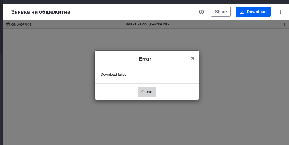

I want to connect OnlyOffice to preview and edit documents.
Document Server version:
Type of installation of the Document Server (docker, deb/rpm, exe, please point us to the installation guide that you used as well):
Connector version: latest Releases · ONLYOFFICE/onlyoffice-liferay · GitHub
v3.1.0 (i use liferay-docs-3.1.0-CE-7.4.jar)
DMS (platform) version: Liferay CE 7.4.3 GA-132 (latest)
OS: Alt Linux
Browser version:
Additional information:
config files to attach
onlyoffice:
image: onlyoffice/documentserver:latest
container_name: onlyoffice_docs
ports:
- “8083:80”
environment:
JWT_ENABLED: “true”
JWT_SECRET: “${ONLYOFFICE_JWT_SECRET}”
volumes:
- ./volumes/onlyoffice/data:/var/www/onlyoffice/Data
- ./volumes/onlyoffice/logs:/var/log/onlyoffice
- ./volumes/onlyoffice/cache:/var/lib/onlyoffice
- ./volumes/onlyoffice/db:/var/lib/postgresql
healthcheck:
test: [“CMD”, “curl”, “-sf”, “http://localhost/healthcheck”]
interval: 30s
timeout: 10s
retries: 10
start_period: 60s
networks:
- liferay-net
logs in onlyoffice container
[2026-03-30T11:42:28.487] [ERROR] [localhost] [e98a8381-2c26-5a8c-9d0d-38156fe69e15_1774866812601] [20123] nodeJS - error downloadFile:url=http://localhost:8082/o/onlyoffice-docs/download/20117/6e4efe8d-99d0-898c-6ded-bcc85abb0904?version=1.0&userId=20123;attempt=3;code:ECONNREFUSED;connect:undefined Error: connect ECONNREFUSED 127.0.0.1:8082
