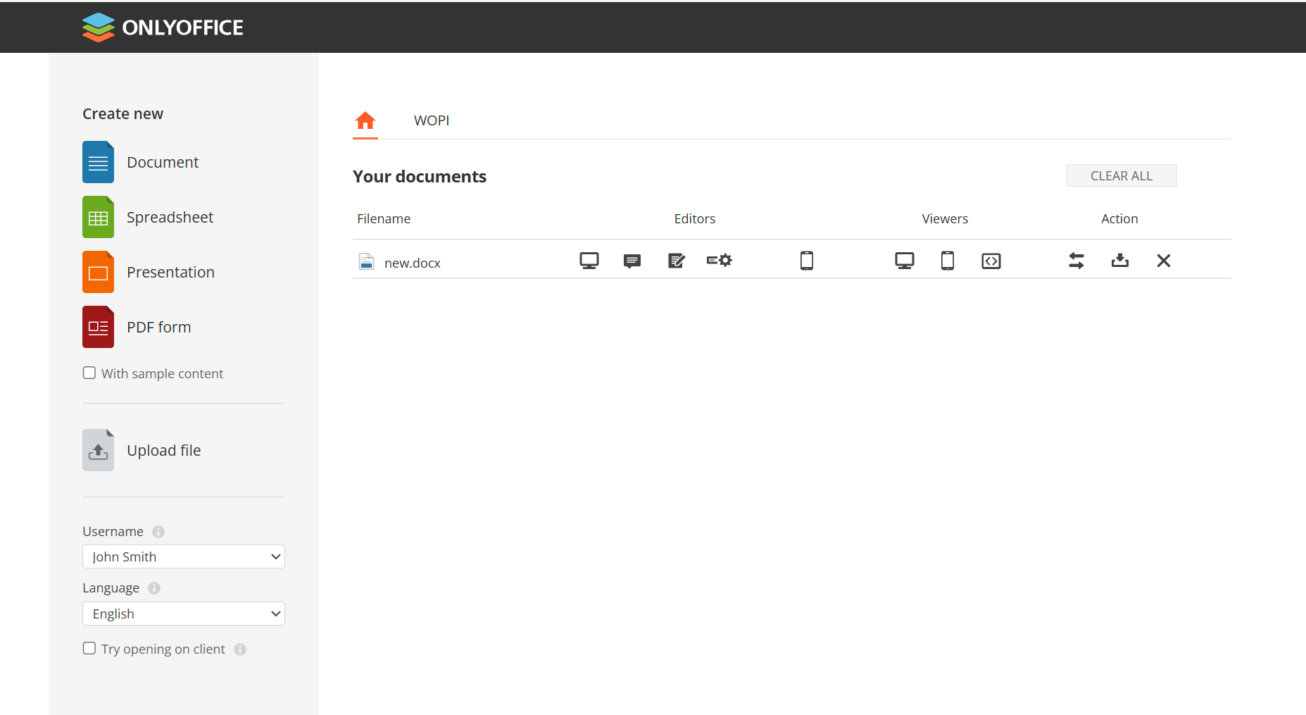

When I completed the installation of OnlyOffice and enabled the example test, I encountered an error when trying to open a file:
“An error has occurred while opening the file.”
From the browser’s developer tools, I can see that all requests return with a status of 200 without any exceptions. However, there are issues logged in the browser console:
