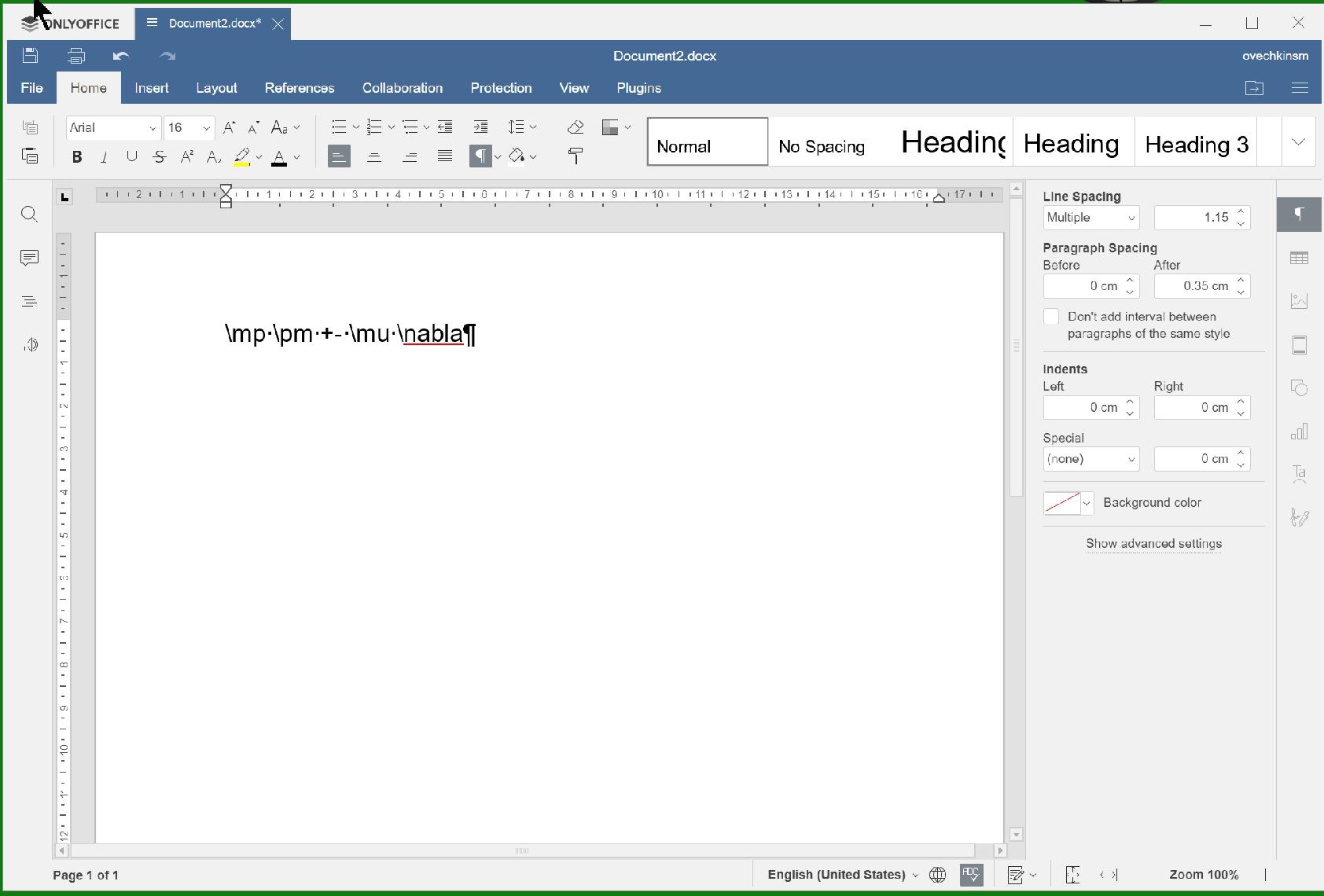

My step-by-step:
Open Document in the Onlyoffice.

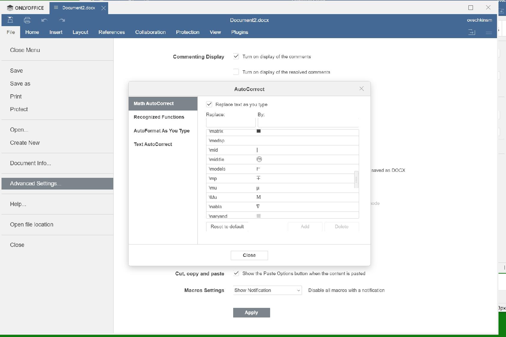

Make sure that at the tab File → Advanced Settings → Proofing → AutoCorrect options the check box “Replace text as you type” is marked.
At the tab Home type \mp \pm ± \mu \nabla. The tiped text is not changed
Screenshot is in the attached file.
Respectfully yours Sergey.

Hello @Sergey
We have checked the situation. The described feature is related to equations. Please double-check this title: https://helpcenter.onlyoffice.com/ONLYOFFICE-Editors/ONLYOFFICE-Document-Editor/UsageInstructions/MathAutoCorrect.aspx
In the equation editor, place the insertion point within the necessary placeholder, type a math autocorrect code, then press Spacebar . The entered code will be converted into the corresponding symbol, and the space will be eliminated.

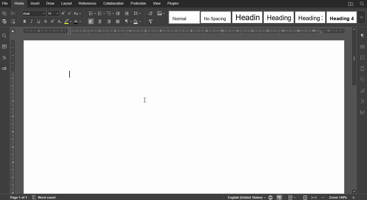

As my colleague stated, Math AutoCorrect works with equation editor only. To use that, you need to navigate to Insert tab, insert an equation field with Insert Equation button and add the value that must be corrected.
Please see this small demo where I use \leq value in the regular canvas first and then in equation editor:
As you can see, once I pressed Spacebar in equation editor, it changed the value to specified symbol.
