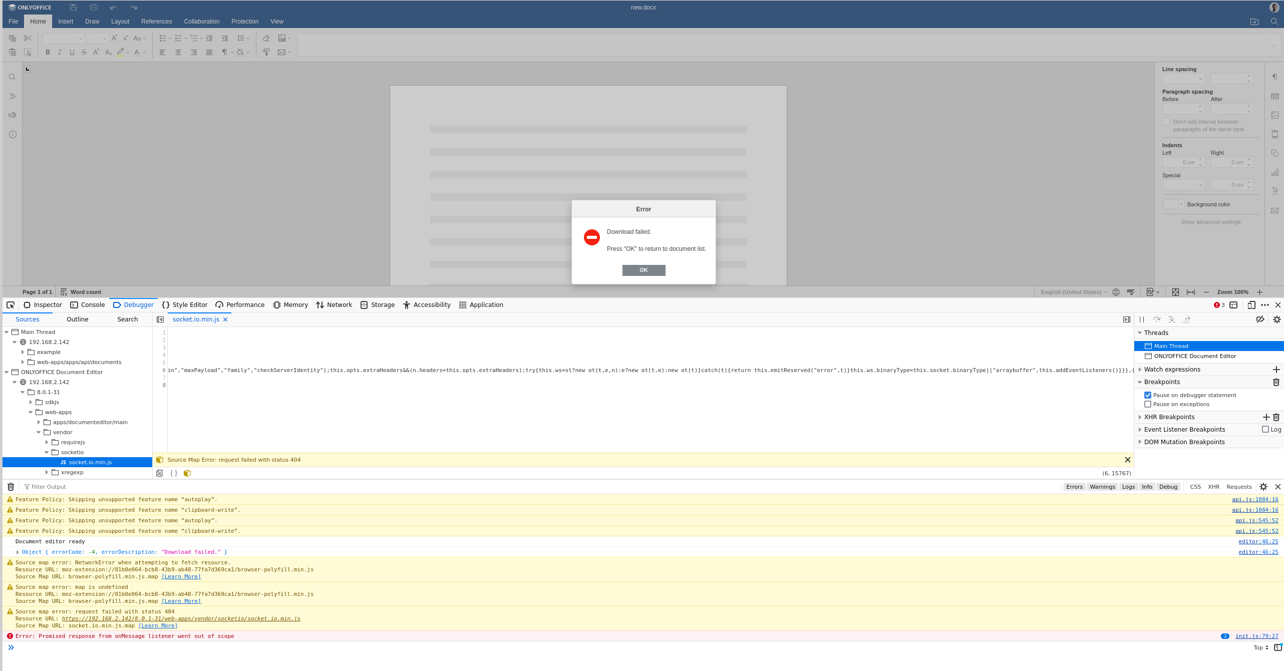

Not much luck - everything seems to work (ds-example) over http - I can open & edit text/spreadsheet documents, close/reopen them. When I try to switch to https, I can open the welcome page (hosted on my local network), I can start the ds-example, but opening (example) documents won’t work. The most success is I get only ‘Download failed. Press “OK” to return to document list’ (see attached screenshot with some firefox messages)

(error) logs:
cat /var/log/onlyoffice/documentserver/nginx.error.log
2024/04/30 03:10:26 [error] 7930#7930: *2 connect() failed (111: Unknown error) while connecting to upstream, client: 192.168.2.15, server: , request: "GET /example/ HTTP/1.1", upstream: "http://127.0.0.1:3000/", host: "192.168.2.142", referrer: "https://192.168.2.142/welcome/"
2024/04/30 03:11:00 [error] 7930#7930: *82 open() "/var/www/onlyoffice/documentserver/web-apps/vendor/socketio/socket.io.min.js.map" failed (2: No such file or directory), client: 192.168.2.15, server: , request: "GET /8.0.1-31/web-apps/vendor/socketio/socket.io.min.js.map HTTP/1.1", host: "192.168.2.142"
2024/04/30 03:21:04 [error] 8531#8531: *127 open() "/var/www/onlyoffice/documentserver/web-apps/vendor/socketio/socket.io.min.js.map" failed (2: No such file or directory), client: 192.168.2.15, server: , request: "GET /8.0.1-31/web-apps/vendor/socketio/socket.io.min.js.map HTTP/1.1", host: "192.168.2.142"

[2024-04-30T03:20:40.202] [ERROR] [localhost] [192.168.2.15new.docx1714446332385] [uid-1] nodeJS - error downloadFile:url=https://192.168.2.142/example/download?fileName=new.docx&useraddress=192.168.2.15;attempt=1;code:null;connect:null Error: Error response: statusCode:403; headers:{"server":"nginx","date":"Tue, 30 Apr 2024 03:20:40 GMT","content-type":"text/plain; charset=utf-8","content-length":"9","connection":"keep-alive","access-control-allow-origin":"*","etag":"W/\"9-PatfYBLj4Um1qTm5zrukoLhNyPU\""};
