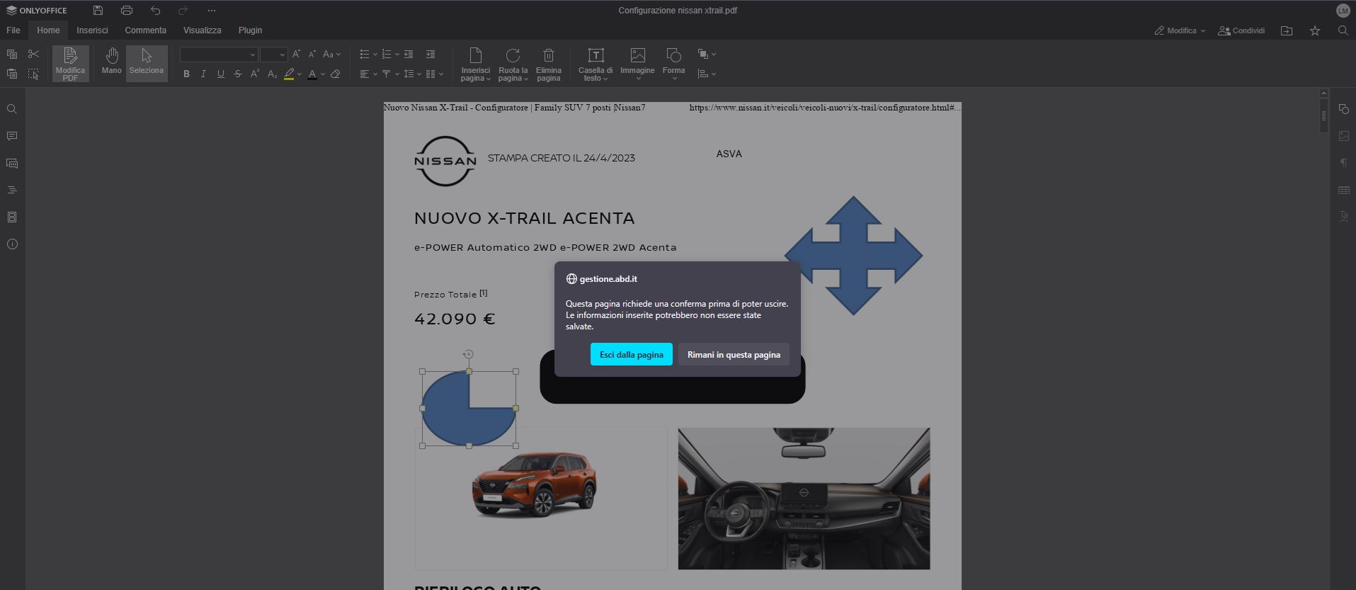

With pdf forms on the other hand, it has been pointed out that by clicking on “Edit PDF” to fill the form, when they go to close the browser tab onlyoffice blocks them with a popup pointing out that they have to explicitly save the edited and filled pdf document, this thing they would like to avoid and have the same behavior as docx, xlsx, pptx.
Is there any additional parameter to set in the client-side call or in the server itself to “force save pdf in edit” and avoid the additional click on the “save” button to the operator ?

Maybe I expressed myself wrongly , the pdf form fill works perfectly, if the pdf is set to “edit” the operator fills the form successfully, but if the operator does not explicitly click the save button in the upper left corner the editor does not save the changes to him because the indicated popup dialog appears and he is used to close the browser tab directly (which is perhaps more correct).

I did not manage to reproduce the issue with Autosave enabled and Fast co-editing mode set up in Advanced settings of the editor (accessible from File tab).
