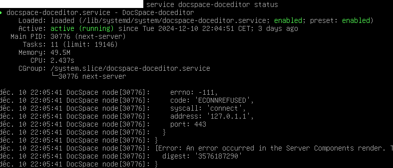

Hello @Roman
Thank you for your help, but the problem persists on the docspace-doceditor service:

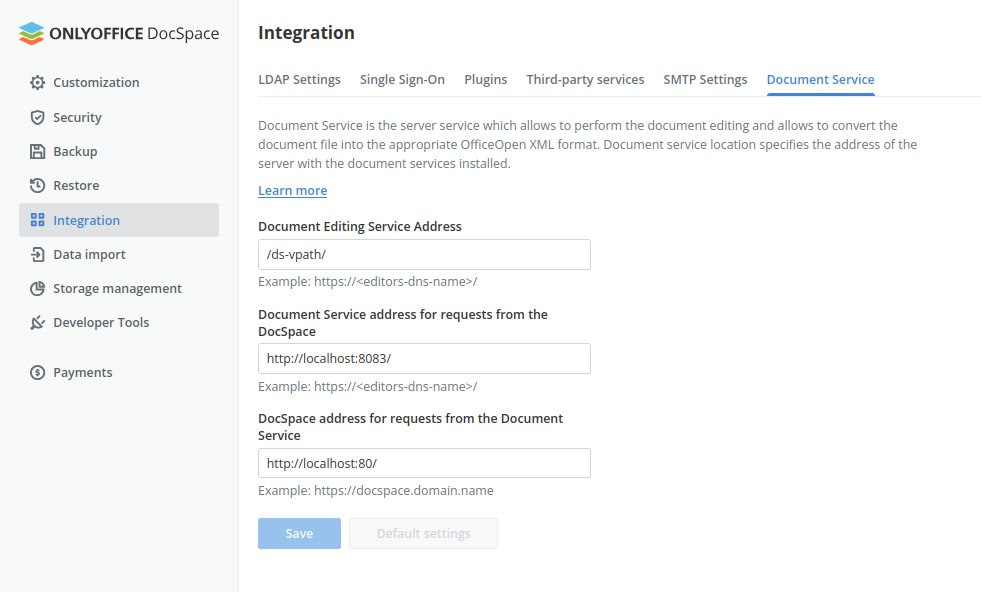

Could you please send a screenshot with the integration setup parameters, as shown in the example screenshot?
thank you @roman, I looked at the integration setup parameters, changing the parameters so that they stick to my configuration. But the same problem always comes back: the docspace-doceditor service always wants to start on port 443. Even using a functional ONLYOFFICE Docs Community, it is impossible to connect to it. I can’t find any logs that could direct me to this or that problem.

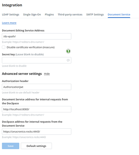

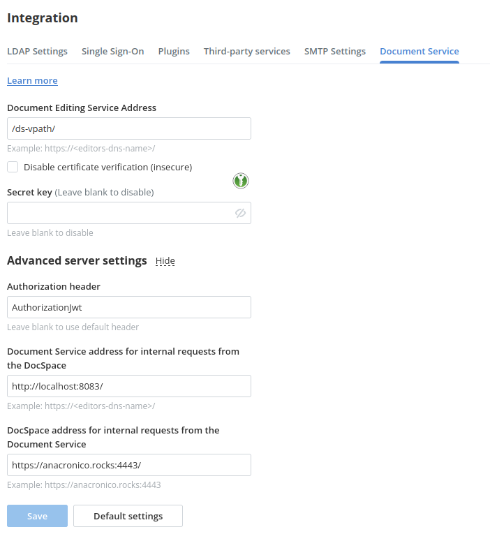

This is how my integrations looks.
Also, I set up ports 89/4443 on /etc/openresty/conf.d/onlyoffice-proxy.conf (showing only the relevant sections):
