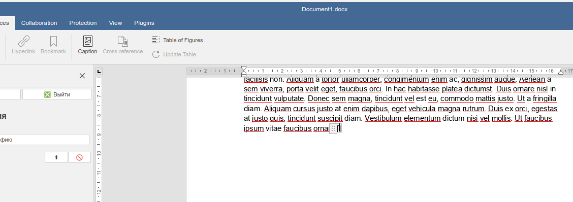

Good afternoon. I am unable to add a cross-reference to a bookmark in my plugin. I want to create a cross-reference to a bookmark in the ContentControl element.

Hi, Constantine. I added logging, for understanding. The bookmark exists in the document.
const onAddCiteCC = async (_cc) => {
            const arrDocuments = [{
                "Props": {
                    "InternalId": _cc.InternalId,
                    "Inline": true
                }, // //cite.AddText("[${_cc.Tag}]");
                "Script": `
                    const cite = Api.CreateParagraph();
                    const bookmarks = Api.GetDocument().GetAllBookmarksNames();
                    console.log('All bookmarks', bookmarks);
                    console.log('I need to add: ${_cc.Id}');
                    console.log(bookmarks[0] === "${_cc.Id}");
                    cite.AddText("[");
                    const isBookmarkAdded = cite.AddBookmarkCrossRef('text', "${_cc.Id}", true);
                    console.log('isBookmarkAdded', isBookmarkAdded);
                    cite.AddText("]");
                    Api.GetDocument().InsertContent([cite], true, {KeepTextOnly: true});
            this.executeMethod("InsertAndReplaceContentControls", [arrDocuments]);

It seems impossible to insert a cross-reference to a bookmark in the Contentcontrol element.
It’s very sad.
I see, thanks. I think the problem is that AddBookmarkCrossRef can be inserted in the paragraph that is already exists in the document as it is stated in the method documentation:
Please note that this paragraph must be in the document.
Considering that, you are using InsertContent with isInline:true it does not actually create a new paragraph as insertion of paragraph into another paragraph is prohibited by the text document structure, hence there is no paragraph object is defined to add crossref.
The only workaround I’ve come up with is to use isInline:false (default value) to separate paragraphs to insert crossref and then “concatenate” current and following paragraphs using GetNext, GetPrevious methods after which next paragraph can be deleted with Delete method:
