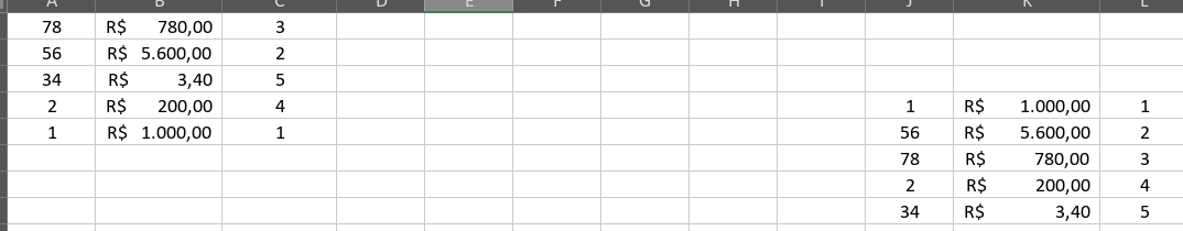

Sure! I created the same table in two different positions of the spreadsheet to demonstrate and two different codes, one for each table but just the table in range “A1:C5” was ordered. (result - image 1).
image 1
Code:
(function()
    var sheet = Api.GetSheet("Test");
    sheet.GetRange("A1:C5").SetSort("A1:A5", "xlAscending", "B1:B5", "xlDescending", "C1:C5", "xlAscending", "xlYes", "xlSortColumns");
    sheet.GetRange("J4:L8").SetSort("J4:J8", "xlAscending", "K4:K8", "xlDescending", "L4:L8", "xlAscending", "xlYes", "xlSortColumns");
Thank you. We are checking this scenario out, I will let you know once we get any results.
We have found out that currently SetSort indeed is bugged, based on received results we registered a bug and started working on it. You will receive a notification when this problem is fixed.
Please accept apologies for inconvenience caused.

Hello @JonatasLima2511
Both issues with SetSort method have been resolved in new 9.3 release of Desktop Editors.
