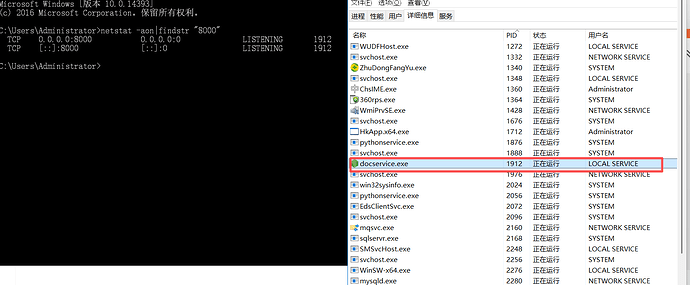

Help: How to modify the port number of docserice.exe?
Hey @dream, :wave:
Just to make sure I’m on the same page — are you trying to change the port for the ONLYOFFICE Docs service (docservice.exe)? If so, could you share why you need to modify it?
Yes, because port 8000 conflicts with another application port.

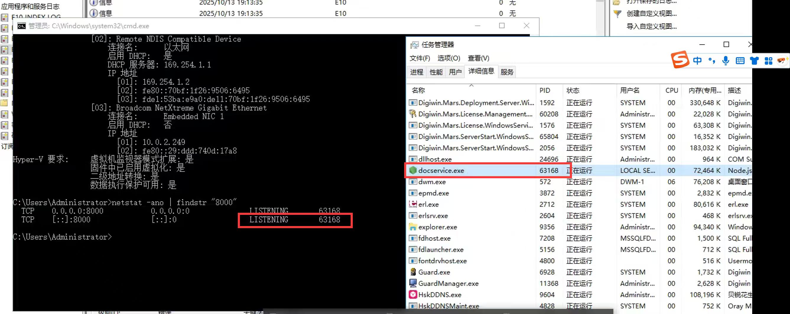

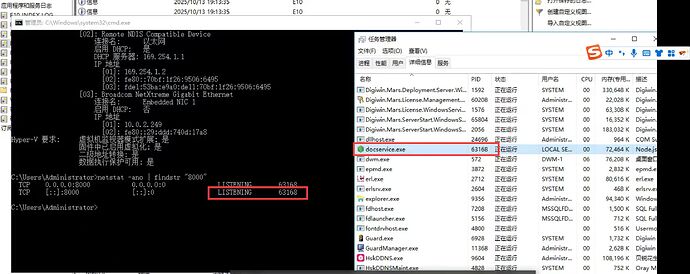

The command ‘onlyoffice-documentserver.exe /DS_PORT=9090’ has been modified.However, it still occupies port 8000 through detection.
Hey @dream, :wave:
Thanks for the update and screenshot — I see port 8000 is still in use even after setting /DS_PORT=9090.
To clarify: the /DS_PORT parameter changes the main ONLYOFFICE Docs listener port (the one the server binds to for external connections, e.g., via browser or editor integration). However, DocService (docservice.exe) internally communicates with other components on port 8000.
So:
  • Your main Docs access will now be on port 9090.
  • But internal services, including DocService, will still use 8000 for inter-process communication.
