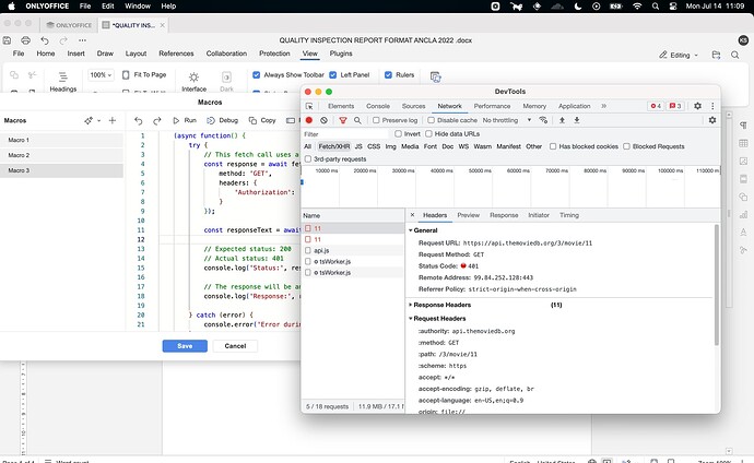

    (async function() {
        try {
            // This fetch call uses a standard Bearer Token for a public API
            const response = await fetch('https://api.themoviedb.org/3/movie/11', {
                method: 'GET',
                headers: {
                    'Authorization': 'Bearer eyJhbGciOiJIUzI1NiJ9.eyJhdWQiOiI5NWY3YjEzMDU5Yjc3Y2Y0NzdjZDQ0YzgwMWNjY2Y5ZCIsIm5iZiI6MTcwMTIzMDQ4NS40NDMsInN1YiI6IjY1NjZiNzk1ODlkOTdmMDBhYjE2MzdkMiIsInNjb3BlcyI6WyJhcGlfcmVhZCJdLCJ2ZXJzaW9uIjoxfQ.CEIa1g1K99ABHBLBuT4jEhseSZaYmEeuxkDWalnIC0s'
            const responseText = await response.text();
            // Expected status: 200
            // Actual status: 401
            console.log('Status:', response.status);
            // The response will be an authentication error from the server
            console.log('Response:', responseText);
        } catch (error) {
            console.error('Error during fetch:', error.message);
  1. Open the developer tools for the OnlyOffice Desktop Editor to monitor network traffic.
  2. Run the macro.
  3. Observe the network request sent to https://api.themoviedb.org.
Expected Behavior:
The HTTP request should be sent with the Authorization header included, exactly as specified in the macro’s headers object. The MovieDB server should receive the bearer token, validate it, and return a 200 OK status with the movie data.
Actual Behavior:
The Authorization header is completely missing from the actual HTTP request that is sent. The server does not receive the authentication token and correctly returns a 401 Unauthorized error.

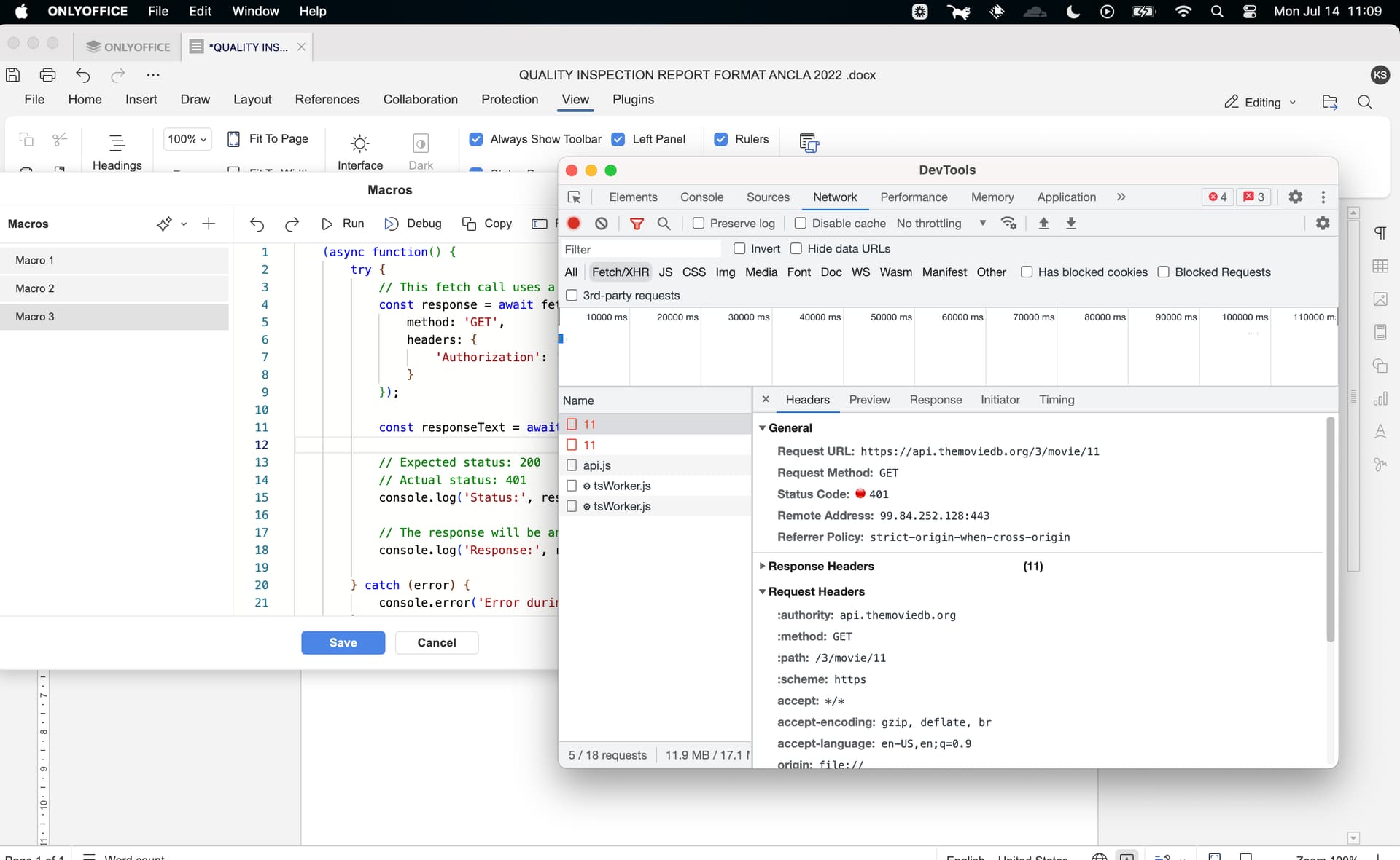

Evidence (Observed Request Headers):
:authority: api.themoviedb.org
:method: GET
:path: /3/movie/11
:scheme: https
accept: */*
accept-encoding: gzip, deflate, br
accept-language: en-US,en;q=0.9
origin: file://
sec-ch-ua: "Chromium";v="109"
sec-ch-ua-mobile: ?0
sec-ch-ua-platform: "Mac OS X"
sec-fetch-dest: empty
sec-fetch-mode: cors
sec-fetch-site: cross-site
user-agent: Mozilla/5.0 (Macintosh; Intel Mac OS X 10_15_7) AppleWebKit/537.36 (KHTML, like Gecko) Chrome/109.0.0.0 AscDesktopEditor/9.0.3.29 Safari/537.36
The following headers are what the server actually receives from the OnlyOffice client. As you can see, the Authorization header is not present.

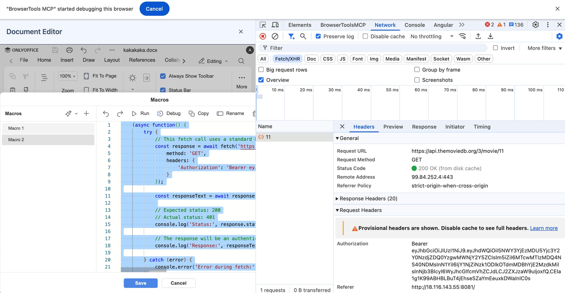

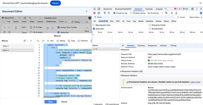

Additional information:
If I run the macro from the only editor (Angular) it works without problem.
Angular

Update: This behavior is expected. You can execute this macro from a separate Document Server’s editor, but not from a local desktop app. Such functionality for Desktop editors was not planned.
Please accept our apologies for the inconvenience
