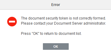

And when I use the built-in test example it tells me this:
Do you have any idea what I could do to get this one to successfully reconnect to my Nextcloud?

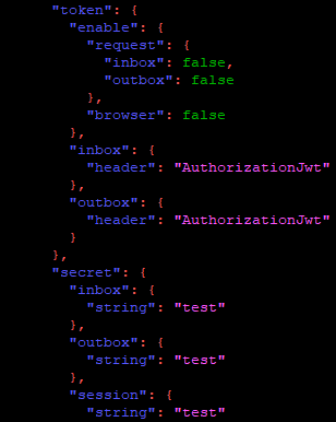

So I have this in my local.json file :
And when I enter on my nextcloud the address and then the secret key indicated in the local.json file, I always have the same error message which is : “Error while trying to connect (An error occurred in the document service: Error while downloading the document file to be converted.) (version 7.3.0.184)”.

As I can see, you have JWT Token disabled. That way you have to leave Secret key field blank in the connector settings.

I have this in my local.json file:
"token": {
"enable": {
"request": {
"inbox": true,
"outbox": true
"browser": true
"inbox": {
"header": "AuthorizationJwt"
"outbox": {
"secret": {
"inbox": {
"string": "test"
"outbox": {
"string": "test"
"session": {
"string": "test"
On Nextcloud I added the line :
