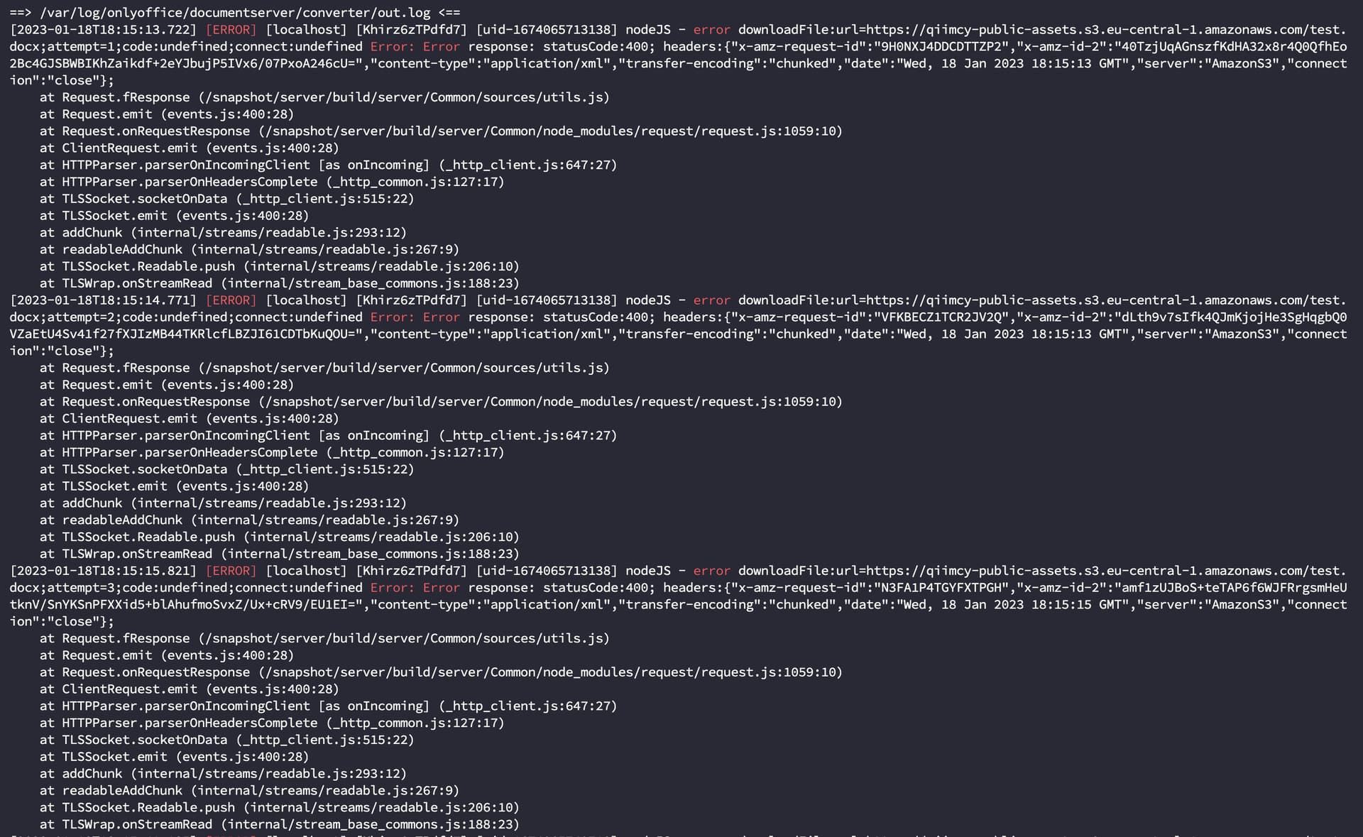

When I go on the server logs, I have :
nodeJS - error downloadFile:url=https://***/test.docx;attempt=3;code:undefined;connect:undefined Error: Error response: statusCode:400; headers:{“x-amz-request-id”:"",“x-amz-id-2”:"",“content-type”:“application/xml”,“transfer-encoding”:“chunked”,“date”:“Wed, 18 Jan 2023 16:06:21 GMT”,“server”:“AmazonS3”,“connection”:“close”};

This is the full error, I have this error each time I try to open the editor

I think you’re right and this is a JWT problem. I made network logging and the Document Server send JWT/Auth headers to AWS that AWS refuse.
