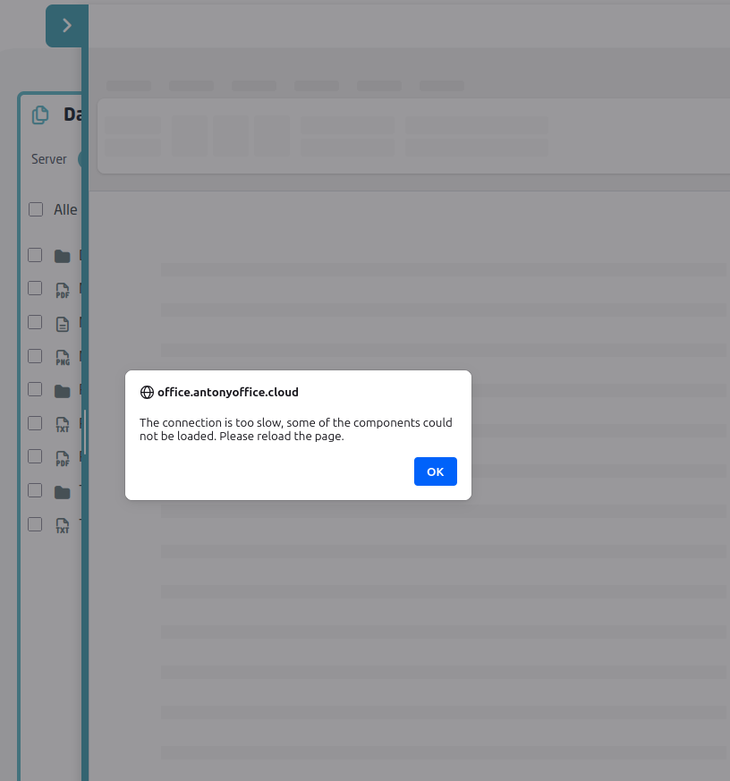

I’m using a community document server and develop a vue project and nextcloud to create an file-browser-client which can open files with onlyoffice (pdf, docx, …)
Generally I can select a file in my filebrowser, I dynamic create a config for onlyoffice, and the file opens.
Then, I close the editor and click on another file - and I’ve got an error:
If I close the editor again and select the first file - everything is ok.
If I reload my app I can open every file correctly, but closing and opening another file will give the error again.
Summary: After loading my app I can open one random document. After closing I cannot open any other document.

I dont know why, but when I tryed solving the problem the next day - without any changes - it works perfectly.
Hello @diegroupware
So far seems to be a network issue. However, please let us know if it still occurs, we will try to make a closer look at the situation.
I hate to say it, but the error returns.
How can we investigate possible network errors?
But please remember:
I can open any document. Then I close onlyoffice and trys to open another document the error occurs. But when I try to open the first document again, this still works.
What I just find out:
The problem happens if the document key changes.
What is required to switch to a new document.
Hello @diegroupware
Sorry for the late reply.
It seems we’re able to reproduce the situation. We’re working on it. I will contact you as soon as possible.
Hello @diegroupware
We have found a bug in this scenario (Vue sample), and we have started working on it.
We want thank you for the reported data! We will notify you once a fix is released.
Hello @diegroupware
You can try to use this step as a workaround solution while we’re working on the bug. You can start removing DocsAPI object when unmounting the Vue component. As an example, you can use such approach:
if (window.DocsAPI) { delete window.DocsAPI;}
Once the bug is resolved, we will let you know. Please accept our sincere apologies for all inconvenience caused.
Update: Please update your installation to v.9.2 and re-check the situation.
Thanks a lot for the workaround.
This helps at the moment.
I’m looking forward and waiting for the final solution.
Dear @diegroupware
Please update your Document server to v.9.2 and re-check the situation. Please let us know the result.
Yes, the Problem is solved
